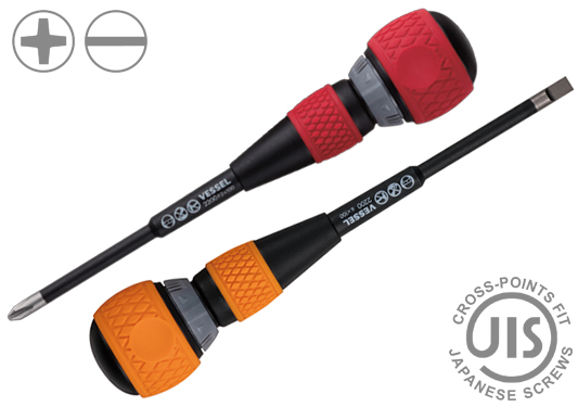

Yes. JIS. JIS is superb. And my brand of choice is "Vessel", made in Japan. It is rare I allow an electric screwdriver within 10 feet of my airplanes.
Vessel ball grips are my favorite of their models.

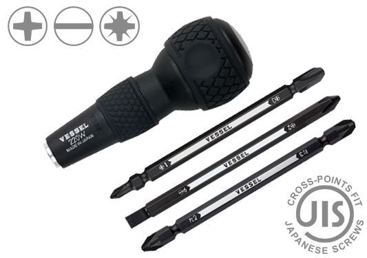

The one I put in each aircraft is the 220-W JIS combination driver:
The one I really like in the shop is a 2200 series ratcheting ball grip:
Yes, I have the Snap-On sets and even the ubiquitous Snap-On ratcheting driver. But I find it hard to beat the quality of Vessel and the ball grips fit my hand perfectly. When I hand one to a friend and they start using it they really like the feel.
