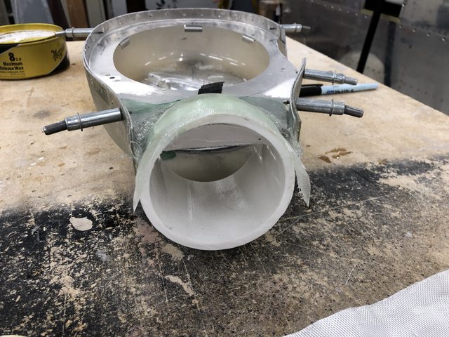

That's an airbox for a vertical induction engine. A snorkel links a horizontal induction to the left cooling air inlet.
As for those seals on the airbox inlet....leakage there pressurizes the lower cowl volume, reducing deltaP, and thus reducing cooling capability. Make sure they seal well.

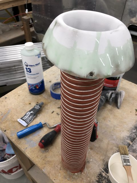

I'm striving for no leaks and easy-off lower cowl

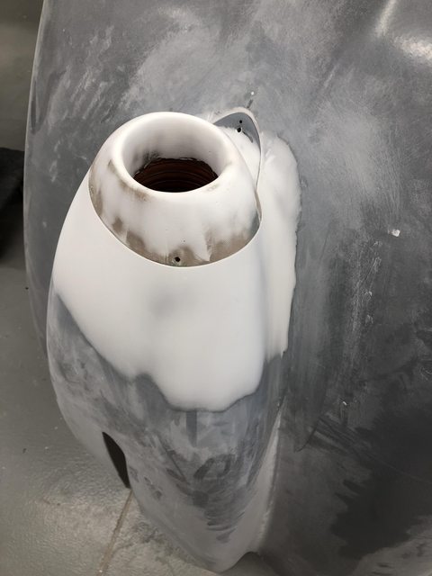

Work in progress. SCAT will be trimmed to length and terminated with a ring of self-fusing silicone tape to mate with the FAB opening.

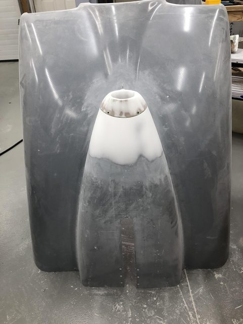

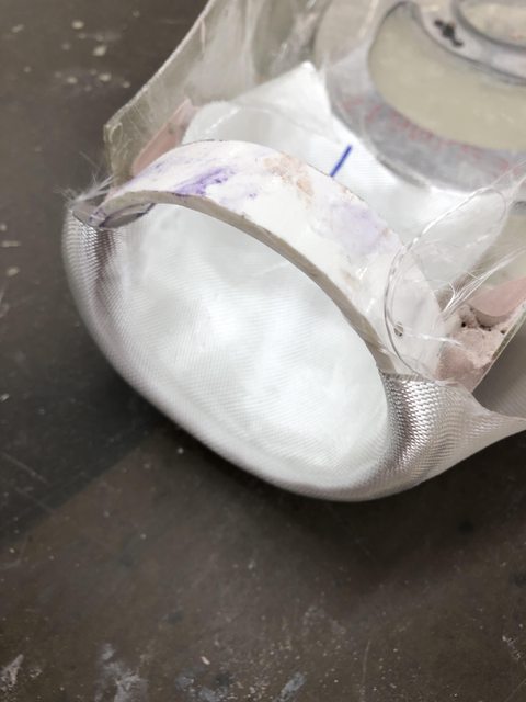

Are you making a mold ? How do you undo the scat tube to pull the cowl? Maybe i will copy seems like a nice idea. Thanks for sharing.
No mold necessary. Piece was cut from the front snorkel, flange was molded into the cutout opening, cutoff wheel kerf was filled with micro to make a tighter fit. PVC was fitted into the air scoop opening and Bondo'd in, SCAT fitted into the PVC stub with Permatex Ultra gasket silicone on outside of tube. Fiberglass over-wrap on the scoop, down into the throat of the intake, bonding the SCAT on the inside surface. This made the piece thicker that stock, so micro was used to build up the corresponding profile on the lower cowl to equivalent height.
FAB was chopped shorter than standard, more schedule 40 was fitted into the opening and a fiberglass upper transition was molded over clay to complete the transition into the FAB body. More fiberglass to hold the PVC stub in place. Sanded a chamfer on the inner edge of the PVC to give a tapered mouth for the SCAT to plug into in service (under slight longitudinal compression is the plan.) . I have more to do here and will post up pictures when done.
The idea was taken from elsewhere on VAF. Fellow named GregMac.

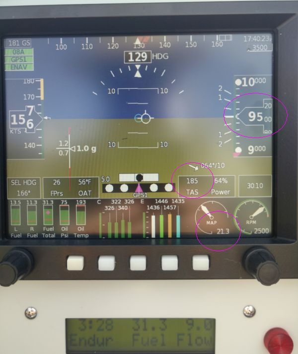

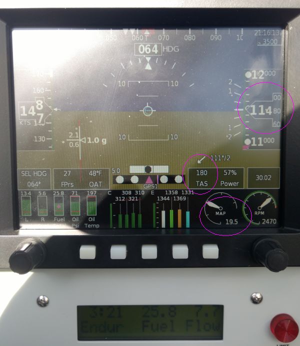

BTW, as a reality check on the estimates, here are panel shots from a trip to PA last week. Note these MP figures are for a horizontal ram airbox, not a snorkel.
9500, peak EGT, WOT. Static would be 21.0 Including adjustment for 23F above standard, recovered Q would be 1.174 x 75% = 0.88 (the 75% is computed from the spreadsheet). The total before the filter is thus 21.88". The tract loss was 0.68", so the estimated MP would be 21.2". I'm actually showing 21.3, pretty close.
11500, 60 LOP, WOT. I show 19.5" at 180 KTAS. Static would be 19.41. Including adjustment for 30F above standard, recovered Q would be 1.03 x 75% = 0.77". The total before the filter is thus 20.18". The tract loss was 0.62, so the estimated MP would be 20.18 total less 0.62" tract loss = 19.56" I'm showing 19.5"

I?m the same MP as you at 9500. A little higher at 11,500. Not sure why my KTAS is only 165 to your 185? What engine and prop do you have? I know the 8 is a little faster than a 7 but dang you are smoking...

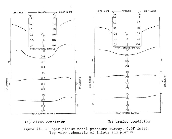

Thought about it, poked around in some papers. Let's assume Carl and Steve are reporting very accurate manifold pressure. That being the case, why would MP be higher than the estimates I provided? The obvious answer is one of the inputs to my estimates is wrong. The most likely potential culprit is the discount I've applied to Q, dynamic pressure. For both estimates I factored Q by 0.8, because for a good cowl, it's a reasonable estimate of Cp, coefficient of pressure, as defined in CR3405:
Cp = (local pressure at measurement point less freestream pressure) / available dynamic pressure
For example, if average plenum pressure is measured at 21.8, freestream pressure is 21.0, and available Q is 1.0, we would have:
Cp = (21.8 - 21) / 1 = 0.8
A factor of 1.0 (full dynamic pressure available at the face of snorkel filter) would add about 0.2" Hg to the snorkel estimate, bringing it closer to what Carl and Steve report. Is it possible?
Answer is maybe. The 0.8 factor is based on average plenum pressure. However, in reality the upper cowl pressure varies a bit depending on exactly where it is measured.
This is an upper cowl pressure survey from CR3405. Cp is as noted above. Note that in the low AOA cruise condition, Cp approaches or even exceeds 1.0 within the intake passage, right where the snorkel filter is located.
(Side note...the very good Cp in the climb condition reflects how well a large outboard inlet can harvest the dynamic pressure in propeller outflow.)
Returning to our OP's question (which is better, snorkel or scoop?), what we have here is a suggestion that a snorkel can outperform a horizontal ram. It's only a suggestion, because it rides on data taken with a cooling inlet unlike the stock Vans cowl inlet. If someone would like to actually measure static pressure at the face of a snorkel filter, I would be happy to help. Obviously I find this stuff interesting ;)

I’m the same MP as you at 9500. A little higher at 11,500. Not sure why my KTAS is only 165 to your 185? What engine and prop do you have? I know the 8 is a little faster than a 7 but dang you are smoking...
The same MP at the same altitude (assuming the same OAT), again suggests your reported MP is either (1) too high for reality, or (2) the snorkel's inlet location in the left cooling air ramp has a higher Cp. (see previous post).
