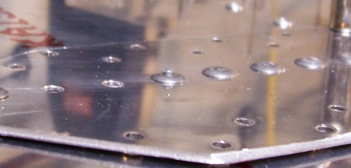

I did the service bulletin today on the right wing which I still had in work so had avoided installation of the rivets that were required to be drilled out. I seem to have an issue with the 5/32 rivets that was being addressed in this thread. I used a #22 drill per the instructions for the 8 holes. All of my 8 rivets ended up slightly higher than the manufactured head. I used two different manual pullers and also my pneumatic puller. I got similar results with each one. The picture shows close-up of the stems. Looking at the pieces that broke off the break is in nearly the same place on every one of them. What should I do now? I'm afraid if I try grinding or filing on the stems it will loosen them. My shop heads look exactly like they should based on the other pictures I have seen.
All eight of mine broke proud of the rivet head also. I filed 'em down flush with the rivet head. The trick on that was, do the 5/32"rivets first, and counting from inboard, do #8 first, then #7, and so on trying not to scratch the doubler with the file. The picture below is also a link to my blog post on the SB.

I sacrified three of those BSPQ and practiced on a scrap piece. The first one I pulled by the hand riveter, the others by the pneumatic puller at 40..45psi. All stems broke proud.
To install the doubler I followed Kevin's suggestions. I started with the 5/32" from outboard to inboard.
After each rivet, I filed down the stem. All stem broke proud 3/64" above the dome head. The trick is go slow and
to take your time while filing. Constantly check that you don't scratch the doubler or (even worse) the skin. There's not much clearance.
Then I installed the cherry followed by the AD41H and finally the LP4-3. (whouu 4 different types of rivets for a doubler plate :eek:)
At the end, I smoothed the BSPQ row by 400 sanding paper and finally scuffed the doubler plate by scotch brite pad.
