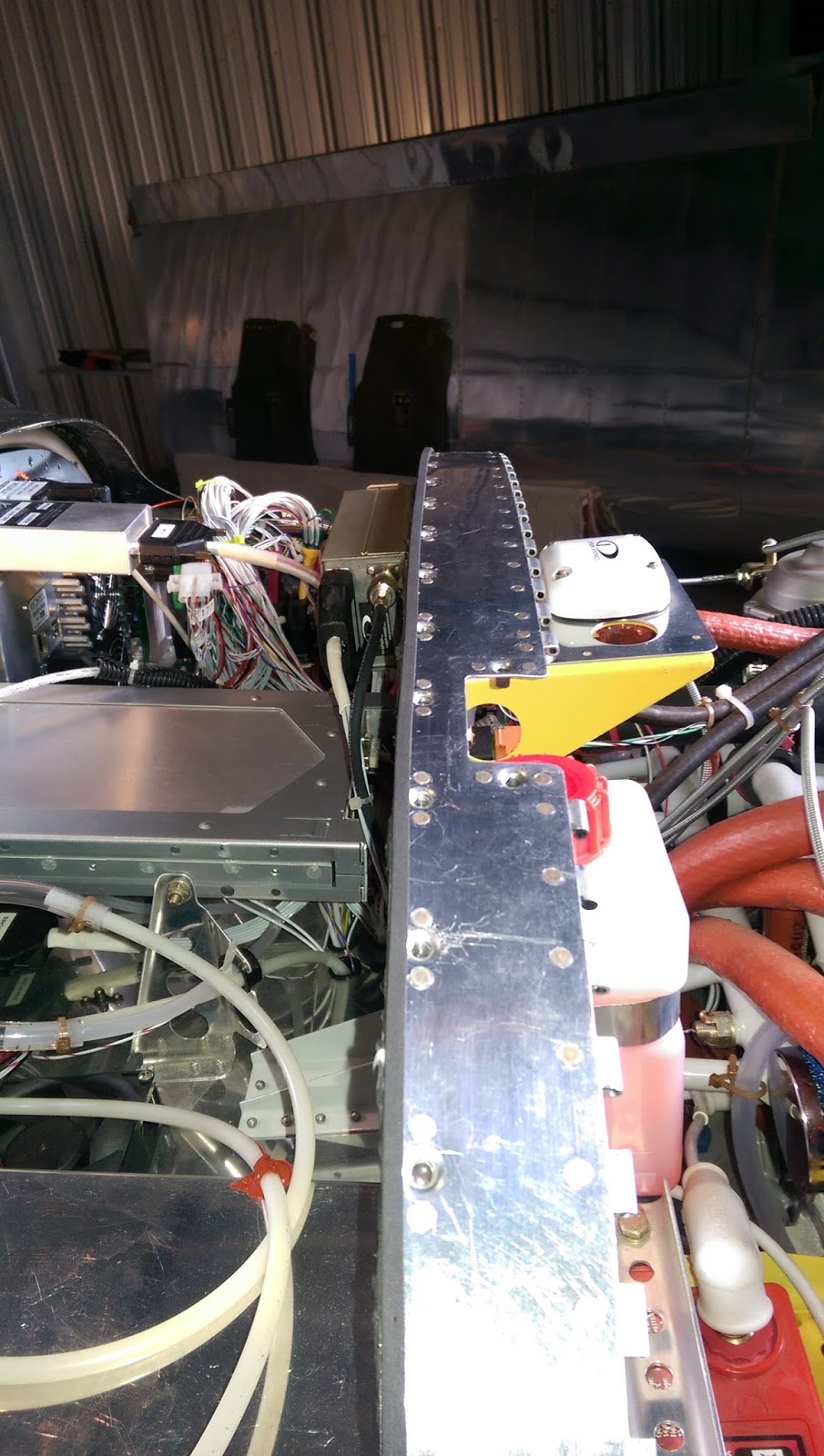

I have had water in the cockpit during flight, but don't know if it got behind the panel. I will happily seal the panel as I have found over the past 30 years, you never know when you might encounter some rain. It is a bulletin so if you don't want to comply with it, don't.:confused::confused:
For once I lucked out, and this SB came out just as I opened the avionics bay to deal with a failed GPS 496. Here in AZ the main issue is dust, and I noted a distinct gritty feel on most surfaces, but I think the main culprit is the small gap between the firewall and the vertical plate the canopy bolts to.
I had a lot of water ingress in real intense non stop rain for over 12 hours and the 12 tied down next to the runway. First time after many flying hours also in rain.
I could start the engine but a lof if things failed in sequence, starting with failing trim and sound on the headset going weird, etc.
When i tried to taxi to a hanger for fault finding also the engine stopped and water poored over my feet.
When I opened the instrument bay there was about 1/8 hinch of water on the tray and the magic box sitting with wet feet.
I never had water coming in during flight after gluing some foam behind the canopy hinge slots.
I found water comes in through the hinge slots and sips under the side panels on to the tray.
When the plane moved forward the water hit the keyswitch pcb shorting the ignition lines.
I managed to repair the box by rinsing, cleaning and drying and elevated the box half an inch by stan offs. Also drilled several drain holes in the tray so penetrating water can get out.
Finally used lots of RTV to seal all seems around the instrument bay.

Who else with flying -12s has done this SB? Per the instructions? Or what methods? I take that cover on and off a fair amount, I am wondering what the "release agent" and seal look like after a couple of on-off cycles? Or is the intent to reseal it every time you take the cover off?
Actually, why are there separate instructions for flying or under construction? That cover is easy to take off even without removing the canopy.
I would prefer to take off the cover, put on release agent on the cover, then the sealant on the plane per the "under construction" instructions, then reattach it and let cure. Rather than remove the front panels and reach in. Anyone try that?
Bill, I complied with the bulletin and within a week pulled the panel. I had to run a putty knife between the two surfaces, but they separated easily.
There are some 12's out there that have not been trimmed appropriately to remove all the screws without removing the canopy first.
Dave - Did removing it (putty knife) tear up the seal?
Hmmm... I am wondering about a thin rubber gasket or tube or something like that cemented to either the base piece or the cover piece, aft of the screw holes but close enough to be compressed when they are tightened down.
I did the sealing SB last week on my completed RV-12. Be careful and make sure your "release agent" really works! That black silicone adhesive is mighty tenacious stuff! I applied two coats of hard paste wax and smeared Boelube on the top panel sheet hoping that that would suffice for the release agent. As per the SB, I applied a very thin (1/16") bead of sealer along the top of the firewall former, reattached the top sheet, and let it dry. That black silicone adhesive cut right through my release agent and adhered the top sheet to the firewall former. Took some aggressive use of a thin putty knife to carefully separate the two. Next time, I think I'll try some axle grease or bacon fat as the release agent. :D

This week we flew up to the AERO show in Friedrichshafen (Germany) from Barcelona (Spain). A real cross countr(ies), along France and Switzerland...
I completed the SB on time and protected throroughly the instrument pannel cover, sealing it acoording to the instructions.
In the south of France we were flying under a heavy rain for about 15 minutes, and a couple of drops of water entered the cockpit though the passenger side.
Few nm later the layout of the screens in the Dynon started dancing, changing from one layout to the next every other second (as if I was pressing the key constantly).
After a couple of minutes of "exciting" trip, the layout stop and I could go to my usual display set.
Following came a new surprise, when a controller asked to recycle my transponder, and there was no way to set the number "5" in the code. Trip continued in VFR code (7000 in Europe) uneventfully, till we land in EDNY.

My biggest water ingress came through the bending holes of the side panels of the dash which I did not seal properly. No more problems after plenty of RTV.
i also experienced ingress after leaving it in heavy rain for a few days but after the top seal trick as per Vans and the canopy cover also covering the fwd rim this is solved. Nothing comes in when flying.
Whenever water gets on the instrument tray it creeps up against the forward side of the panel when the plane excellerates. This may harm the panel buttons as you experienced.
I drilled several drain holes in the instrument tray to make sure that in case ever water gets in it drips on my legs and not into the avionics.
The canopy hinges always leak a bit despite all the things I did to stop it.
