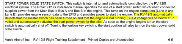

The Start Button Bypass (SBB) is actually activated as soon as the Master Switch is turned on. As long as the main aircraft battery bus voltage is below the programmed threshold (~13.7V) the SBB circuit will stay activated indefinitely.
The problem we are seeing with the new AV-60009-2 HIC Module is people are testing the system with a battery charger connected (or just removed) and the bus voltage is above the threshold due to battery float charge. As soon as the SBB computer senses the bus voltage is above the threshold a 60 second timer is started, so 1 minute later the SBB circuit is shut off.

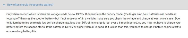

The EarthX battery has a very low self-discharge rate and should not need to be connected to a battery charger except during system testing when the Master Switch is on for extended periods of time and the aircraft isn't going to be flown soon, allowing the aircraft generator to charge the battery. I.E. While testing and configuring your systems before airworthiness.
There is no need to connect a battery charger between flights, in fact, the high float voltage will most likely cause your SBB circuit shut off sooner than you want it to. The EarthX documentation says the "resting voltage" of the battery as 13.3V, which works fine with this system unless the battery has just been charged.

As stated in the FTS, the SBB circuit will be re-activated any time the key switch is turned to the start position, as in an engine restart scenario.
