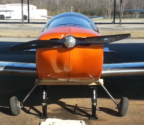

Here's a method I recently used on my airplane. It works because the fuselage is flat on the bottom and I place the jacks pretty close to the longerons. Maybe it will work on an RV-12 too.
I have more information about the jacks here:
http://chrismadsen.org/2016/03/fuselage-jack/
I grew tired of borrowing a friend's heavy wing jack a few years ago and did a search for a better solution and found this thread:
http://www.vansairforce.com/community/showthread.php?t=82111&highlight=jack&page=2
A sturdy base, some galvanized conduit, a large hose clamp, a long-ram jack from Harbor Freight, and some basic hand tools and you can make your own. Stephan's pics seem to be gone from the thread now, but page two has a couple of pics so you can see how it's made.
I took a stock bolt that threads into the tie-down and rounded off the head. Then made a corresponding divot in the jack head. Thread the bolt into the tie-down and you have a jack point. Chock the opposite wheel and place the jack under the bolt and raise the ram until it meets the jack point and you're good to go. Mine works great and, as the thread says, cost me less than $50. Some of the designs and ideas on that thread are good -- but for guys like me who can't weld, the plywood base/conduit/hose clamp/jack design works.
