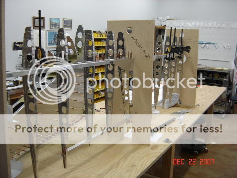

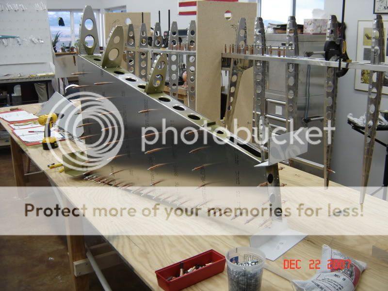

For the S-19 followers
Here's a pic or two of the tail kit for the S-19.
BTW: Rans OEM price for the 912 is still $16200.
Where are all the rivet holes?
:D The RV-12 will be 100% prepunched (all skins and substructure parts).
No jigs or supporting structures required during construction.

I asked the same question when I took these pics. The skins are all punched, just not the ribs and some of the spar. No real answer, but speculation is these are the first tails to be shipped and later ones may have the ribs punched. Everything is going together well. The jigs are supplied with the kit.
The manual and the component quality appears slightly less than my RV-7.

Cool stuff. I've been anxiously waiting to see some pics of one under construction, thanks. Question... the flutes in the ribs... did you flute them or did they come from the factory that way? I ask because the flutes in the picture seem to be wider than those we do with our hand tools.
Cool stuff. ........did you flute them or did they come from the factory that way?.......
I didn't flute any, all I've done is snap the picture. I haven't been over there much lately. But you're in luck...My friend and wife are coming over today for Prime Rib, so I'm certain airplane construction will be the topic for today. He is also a tech counselor and will be inspecting my work thus far.
Here's the scoop. Ribs come prefluted, but not drilled. Jigs are required, but included. This may change now that Rans has gotten S-LSA certification. They are building a new factory and plan on producing S-LSA planes in 10 months. The kits should improve.
