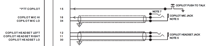

As our first RV-12IS is nearing completion and we complete our final tests, we are having trouble with the co-pilot intercom only.
The problem I am struggling to solve is with the intercom. Pilot talks, copilot can hear. Copilot talks nobody can hear, no side tone either. Yet if co-pilot transmits on the radio the sidetone is apparent either way and the transmission is clear and strong.
The GTR200 is configured correctly. I have also back-to-back tested this radio in a known good airframe (a Tecnam) that I installed a GTR200 in a couple of years ago. It worked fine. So, the GTR200 is not faulty.
I am struggling to think of a wiring issue that could give you perfect radio transmit and receive along with correct sidetone, yet not deliver intercom to the pilot from the copilot.
I would greatly appreciate some help here. I am going to do some more troubleshooting tomorrow (Monday your time), as my focus is now back to what the harness pinouts are, and I would appreciate anything you have to suggest.
(This is a factory supplied Garmin Avionics package)

I would start by verifying that the copilot mic jack is isolated from the panel and that the copilot MIC HI signal (pin 16 on GTR200, ring terminal at MIC jack) and MIC LO signal (pin 34 on GTR 200, sleeve at MIC jack) each have good continuity from end-to-end and are not shorted to ground or other connections.
Steve

That is exactly what we will be doing today. I reckon that is the kind of bug we will find.
I should know better than to trust anyone. This is not the first time, in fact it is several down the list of pre fab harnesses being wrong from a so called reputable supplier. So my big mistake was trusting that.
All three connections on the co pilot mic jack were incorrect. not two but all three.
Works perfectly now.

I too am curious to know what combination of wiring could result in the transmit audio (and PTT) working properly on transmit, but not on intercom mode. Can you say what was wrongly connected to what? Curious minds want to know.
Yeah, no kidding.
This is how it was wired Vs how it should be
Function Supplied Corrected to
MIC + WHT/ORG WHT
MIC Lo WHT WHT/BLU
PTT WHT/BLU WHT/ORG
Yeah, no kidding.
MIC + WHT/ORG WHT
MIC Lo WHT WHT/BLU
PTT WHT/BLU WHT/ORG
Got it, thank you.
So the mike hi line was connected to the usual mike lo, and the PTT was connected to the usual mike hi jack. But the mike is not polarity sensitive. So when the PTT was pulled low, the transmit activated, the mike hi connection provided bias to the mike, with the ground return thru the PTT, and it all worked. But without the PTT activated, that line is at 10 volts or so, as is the bias from the mike high line, so there is no net bias on the mike element and it doesn’t work. You must have a PTT switch on the stick or panel; if you had tried a portable PTT plugged into the copilot jack, nothing would have worked, as the PTT line would never be pulled low. Interesting failure mode.
