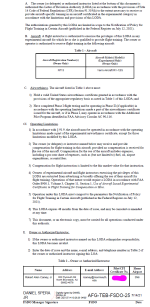

I received my LODA today. If anyone was following this and was concerned. it took only a couple days. Apparently Oklahoma accepts the email request and prepares a fill-in-the-blank form, then forwards it to your FSDO manager for signature. A copy of it is attached here if you're interested in the exact wording.
They apparently do not care what type of instruction I want to receive in my own experimental (add-on commercial/instrument, BFR, or initial pilot certificate)... So in effect, this whole thing is a non-issue.. just a rubber-stamp exercise.

I will have to give credit to the FAA for one thing. I sent my LODA request in on Friday with the information that some of you posted and received a signed LODA back on Wednesday!
I used the FAA template on their website yesterday morning and my signed off LODA was in my Inbox today.
I am guessing the FAA was getting a lot of squeaky wheels to get things greased so quickly since the Warbirds fiasco in court.
My local FSDO serves a LOT of busy airports, so I'd say they are really on top of it, so far.
LODA
Did you receive your actual LODA overnight or was it actually an auto reply stating they received your request?
They sent me they received my request email within 20 or 25 minutes of sending it in yesterday, and probably 24 25 hours later it was digitally signed by someone at my local FSDO on the bottom.
