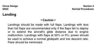

As an aside, in a Cirrus the POH calls for all landings to be made with full flaps. With less than full flaps if you try for a full stall landing a tail strike is possible.
Thanks for the correction/clarification on Cessna flaps and their affect on pitch. It sounds familiar - pretty sure I used to know that and forgot!

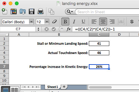

Allow me to take this opportunity to pitch my case for slow landings.
Let me stipulate that if the average pilot touches down at 5, or even 10kts over stall speed, he or she can likely do it for their entire career and never have an issue. But the Law of Large Numbers being what it is, every year we will read accident reports where excess speed was a contributing cause in landing accidents*. I see it across the board, in all varieties of GA aircraft.
Let's say an RV12, with proper technique, can land at about its stall speed of 41kts. Let's further say some pilots are more comfortable "flying it on", and routinely touch down 5kts fast, at maybe 46kt. Does not sound like much worth worrying about.
But energy increases as the square of the increase in velocity. I even made a little Excel spreadsheet to do the math for me:
That silly little 5 kt difference results in 26% more energy at touchdown. Most landings it matters not a whit, and who cares? Maybe a little more tire and/or brake wear, so what? But should something go wrong - a broken axle, a locked or failed brake, a flat tire, T-boning an elk, whatever - that 26% extra energy could be the difference between no injury and a bruise, or between a bruise and a broken bone, or even between a serous injury and death.

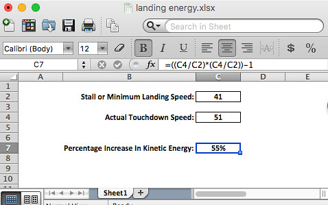

And how many pilots routinely land at 10 kts over stall? Check this out:
That 55% more energy has to be dissipated somehow should an accident occur, often with predictable results.
Anyway, not every plane nor every condition will be conducive to a full stall landing. But I still hold its an admirable goal most of the time in most GA planes. For those who land faster because its "easier", there's nothing inherently "hard" about holding the plane off for another few seconds as the speed bleeds off - all it takes is practice.
