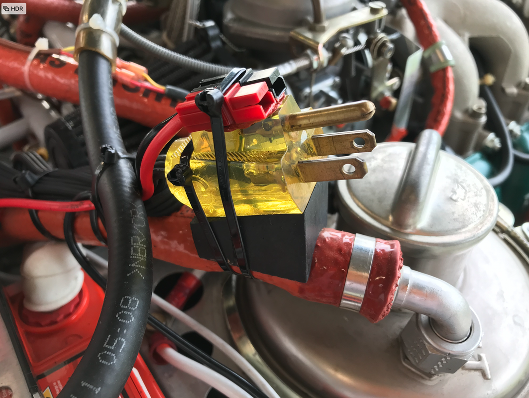

You might want to consider leaving battery on charger during off-operations. I use an Odyssey 6 Amp Portable Charger which I leave connected to the airplane all the time in the hanger. The Odyssey charger is not a float or trickle charger – it is designed specifically for Absorbed Glass Mat (AGM) and flooded lead acid batteries. The charger maintains voltage only as needed, so when the battery is fully charged there is no current flow. The charger has an automatic cycle that disulfates the battery once/month. This cycle also happens every time the charger is reconnected after flying.
Install a pigtail connector near the oil access door for quick connect to charger. See photo below.
I’ve been doing this for two years and battery loves me...
