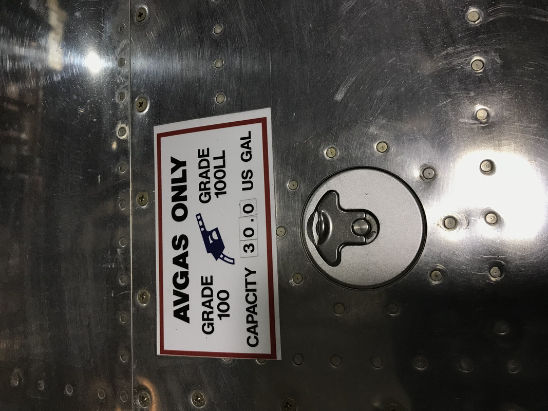

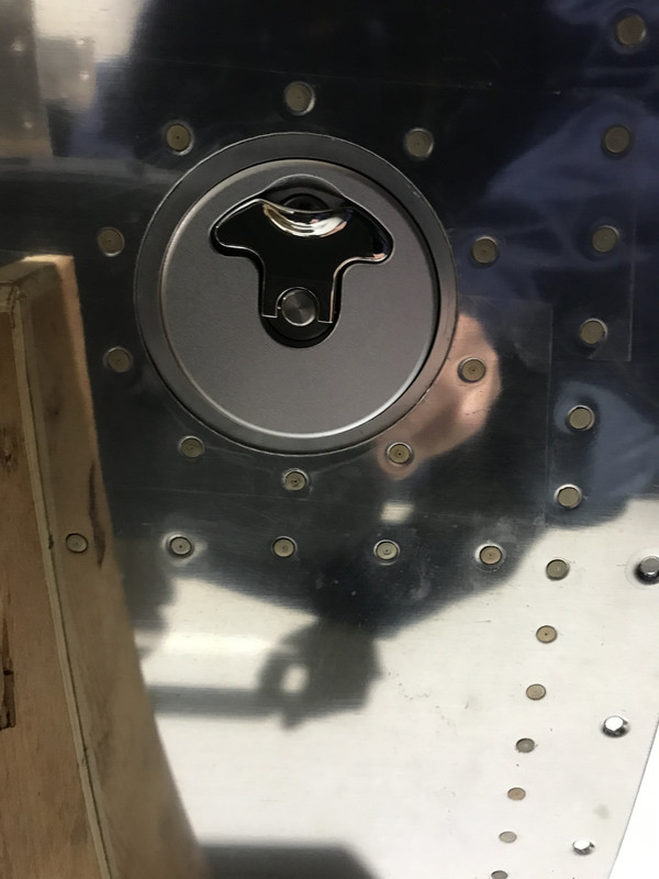

On my standard tanks, I installed the Newton caps that Van's used to sell. Their flanges had a lot of curvature and took significant effort to shape to the curve of the RV-10 skin.
I've bought a set of Newton caps for the ER tanks (on Spruce they have a model that is specifically recommended for the RV-10) and the new caps are much flatter and look like they will fit a lot better. I haven't started fitting them yet, though.

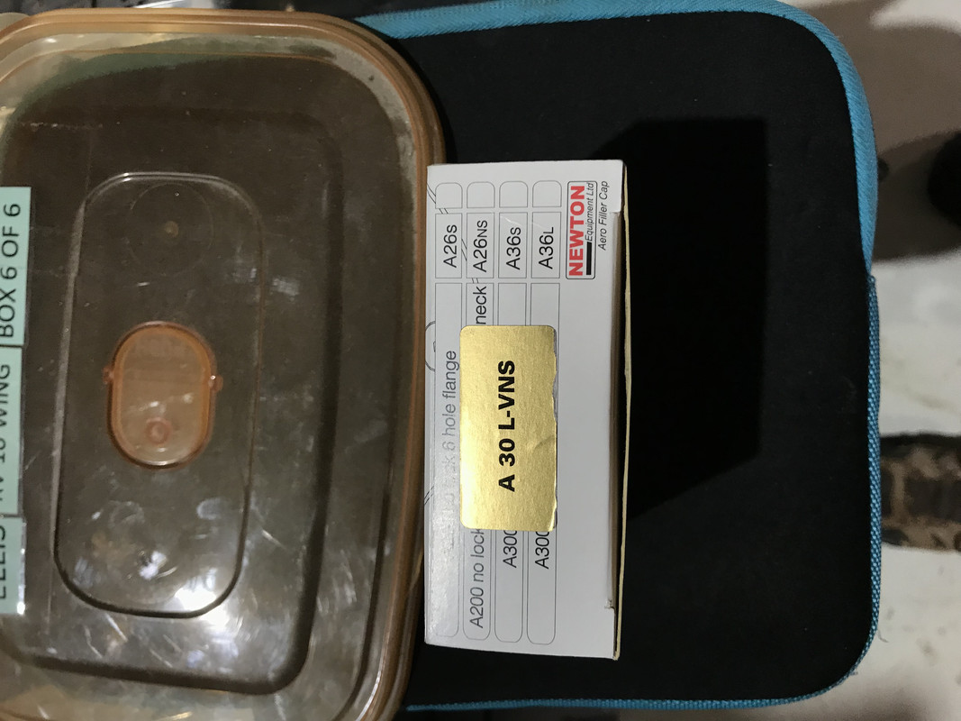

I bought the AERO 300 NON LOCKING FUEL CAP. Is this the set you bought?
I was steered to that part after reading a note in the "Reviews" section posted by "Robin V" (formerly of Newton) on the "AERO 300 - A30 LOCKING AND NON-LOCKING FUEL CAP" product page.

I think Richard covered pretty much everything, but I wanted to provide a little additional detail (and thanks Richard for the explanation of the SW sender series mod).
I installed the Newton Aero 300 caps in my original slow build tanks. They were the smaller opening version and the Newton provided Vans flange worked well.
As Richard mentioned, the new ER tanks for the 10 (and I assume the 14) have the larger opening designed for the Newton SPRL plastic cap. At the time we built our ER tanks, either I was unaware, or Newton had not offered an all metal locking SPRL replacement cap - so we installed the smaller diameter flange and cap. The downside of this is a small reveal around the flange which can be a benefit to reduce paint chipping, but also requires additional effort to ensure the flange is centered on the opening. (Ours is centered, it just looks off center in this picture).
According to my Spruce order history, this is what I bought:
https://www.aircraftspruce.com/catalog/pnpages/05-26740.php
The one you linked appears to be the one with a lot of curvature to the flange.
In these pics you can see that the Newton caps I bought (details above) Are smaller in diameter than the hole in the ER tank skins, but that there's a ridge, unlike in other pictures, and the overall difference appears to be less.
That ridge should allow me to fill the empty space with a decorative bead of Proseal or some other flexible sealant like Silpruf (not sure if that's fuel proof).
