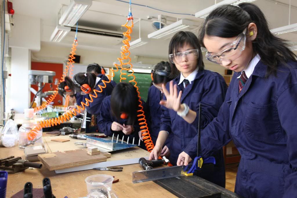

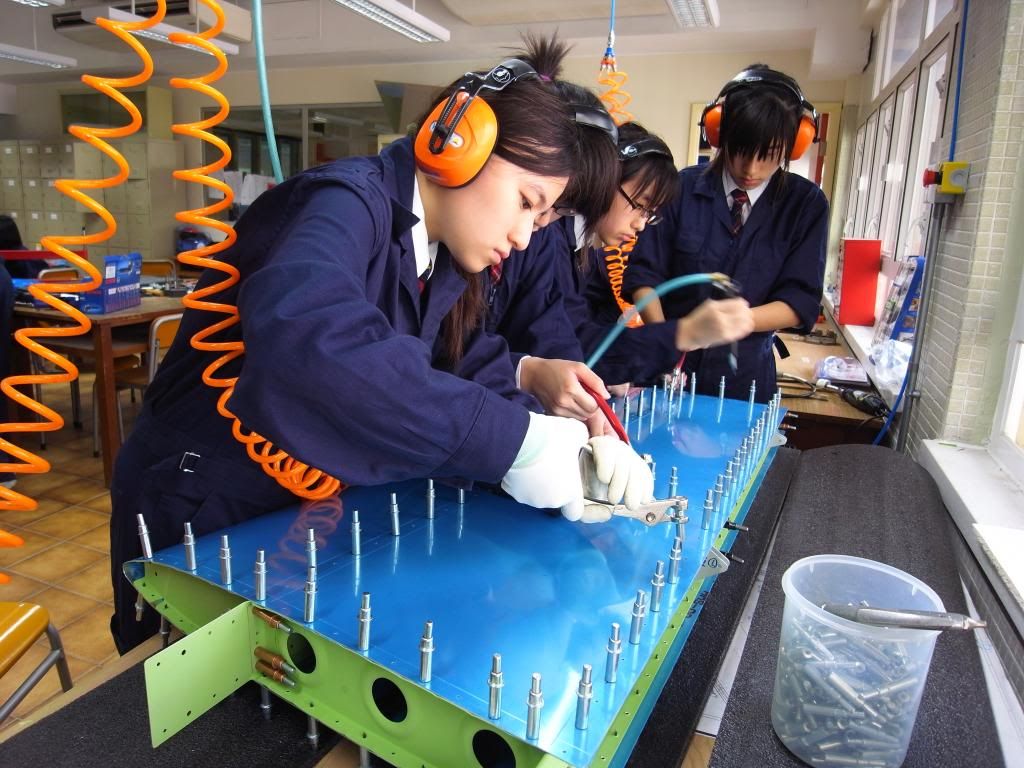

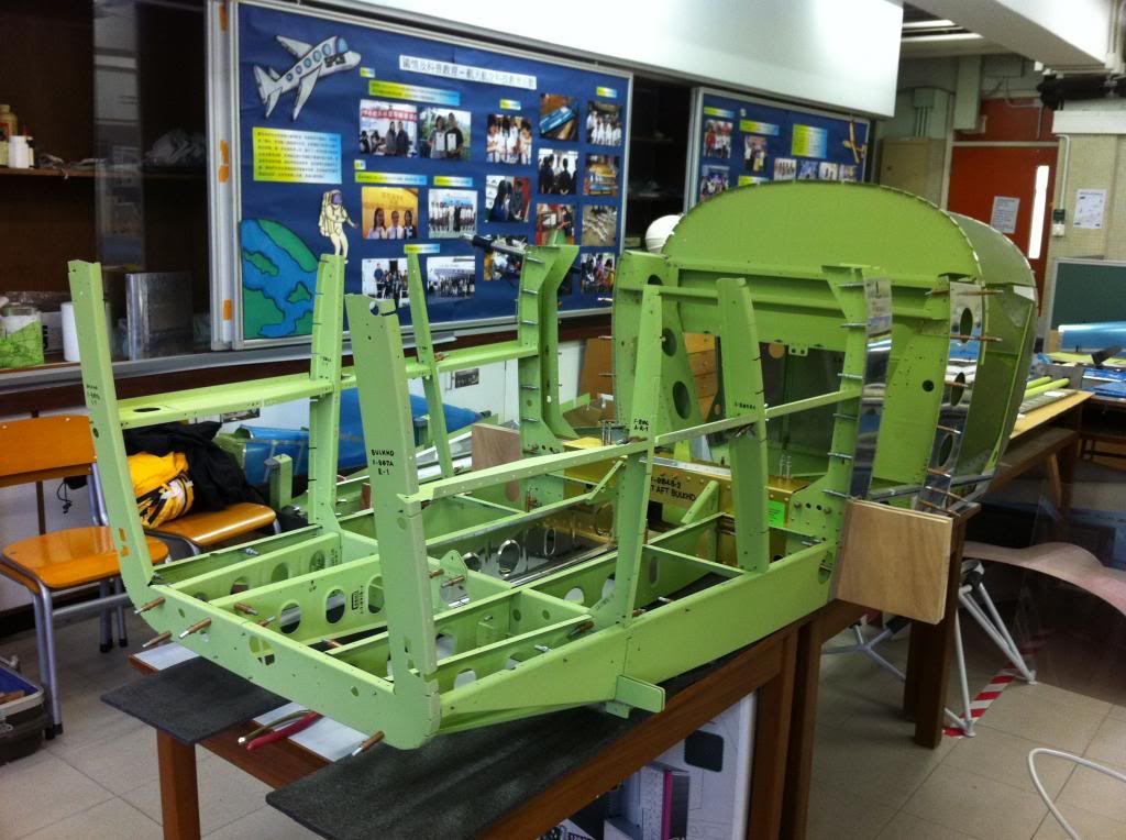

Student took 3 months, every wednesday, to work on the practice kit and learn how to use tools and sheet metal work.
Once they finished the practice kit, they move on to the real thing. Here they plan their work...
....and just do it

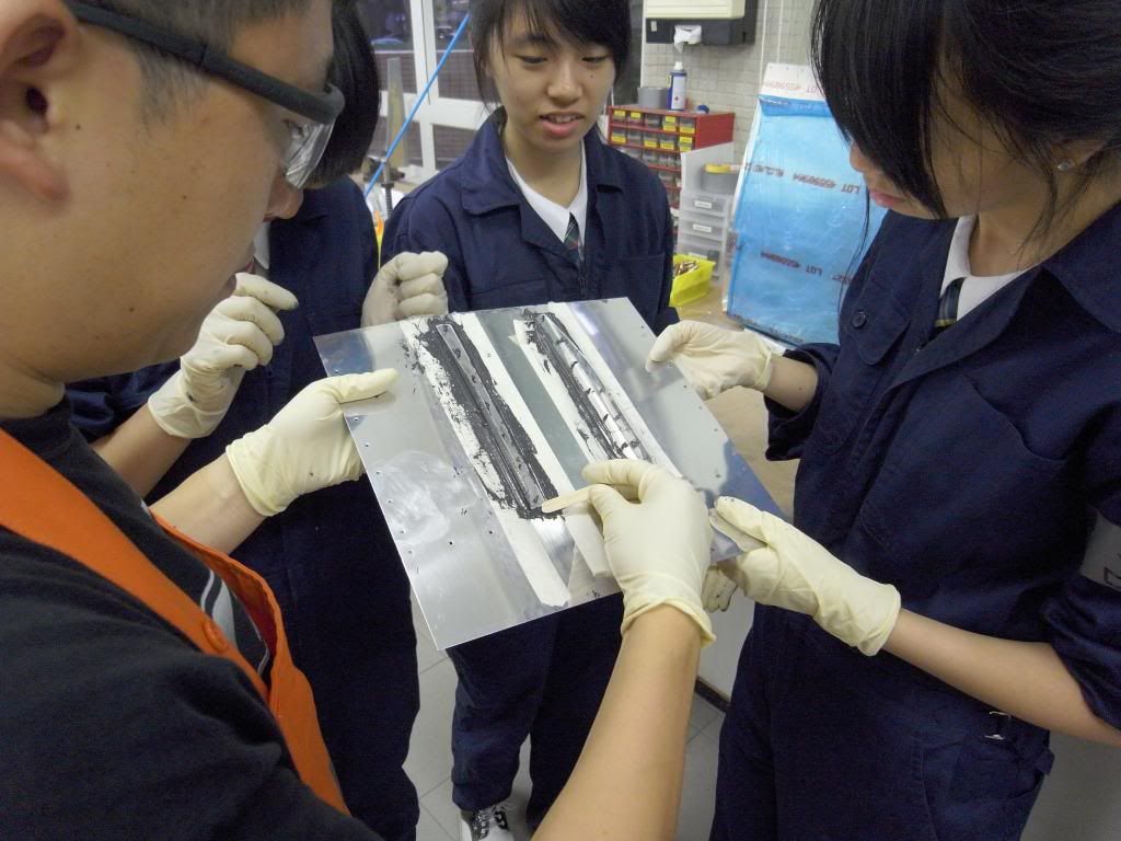

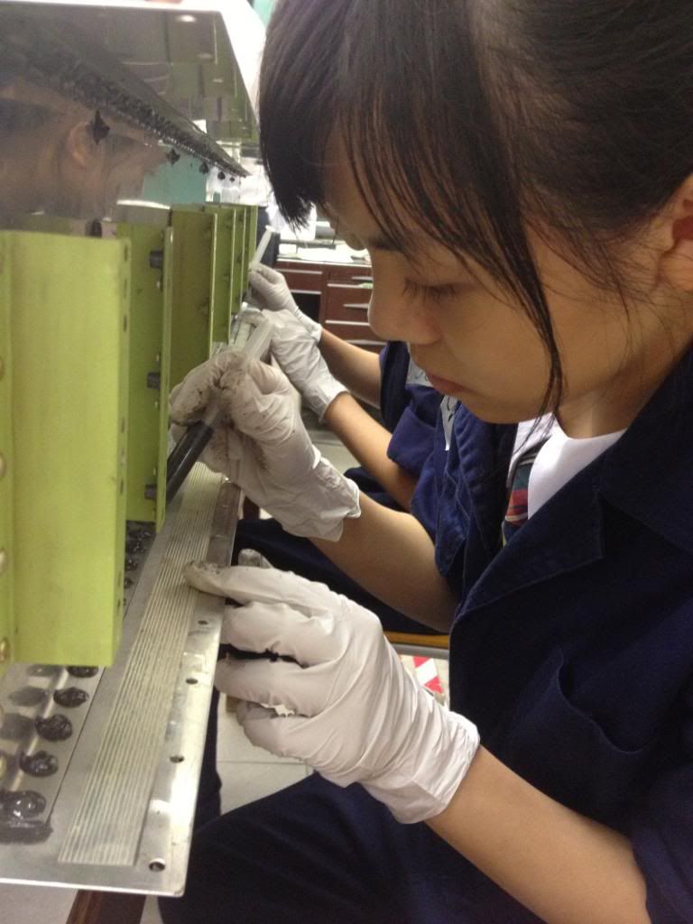

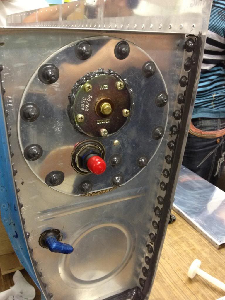

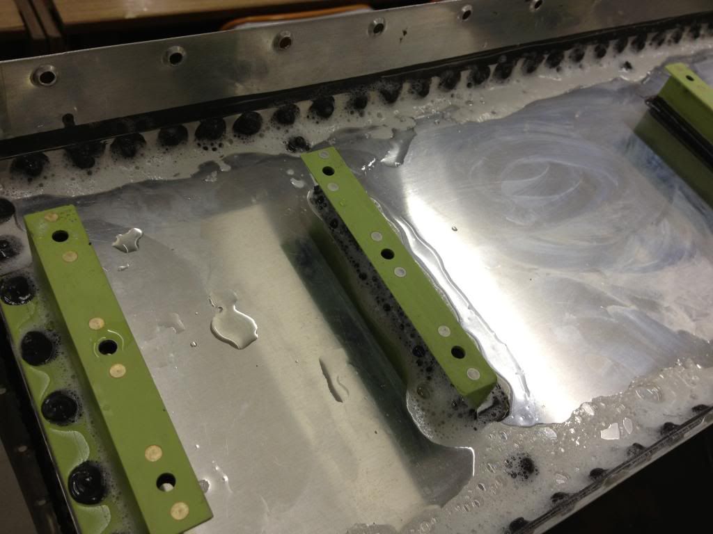

Fuel Tank Stuff

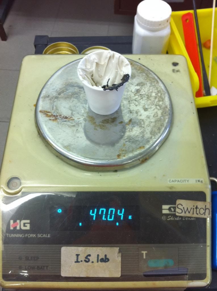

They get their fair share of Prosealing
10:1 by weight. (Precision Scale: courtesy of Chemistry Lab)

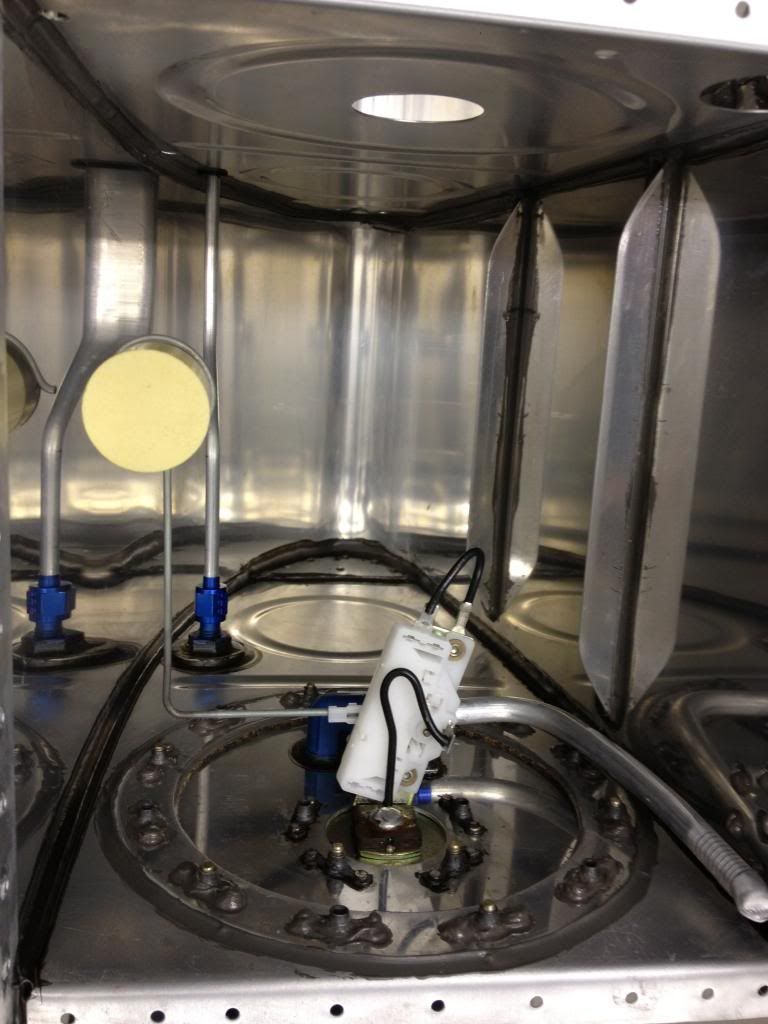

Tank Stiffeners
Sealing the rivet heads

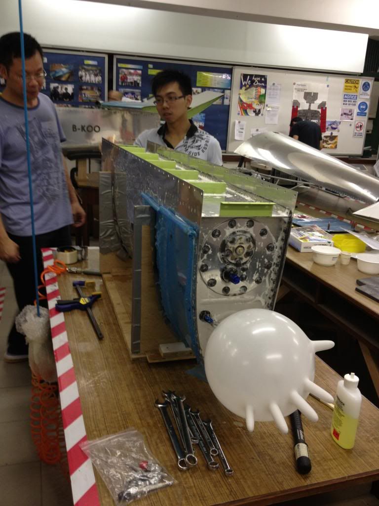

Before we close it up
Sealing the rivets and screws head
Leak test, no bubbles!
No Leak! Engineers and mechanics helped with closing the tank and leak test.
Very nice workmanship! I love how the end of the tank cover screws have matching round globs of proseal! Plus the young lady applying to the shop heads on the rear bulkhead is doing a very professional job.

I'm jealous, your students have done such a nest job with the pro seal.

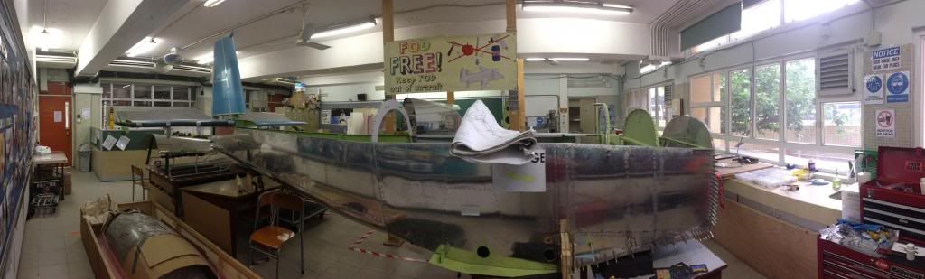

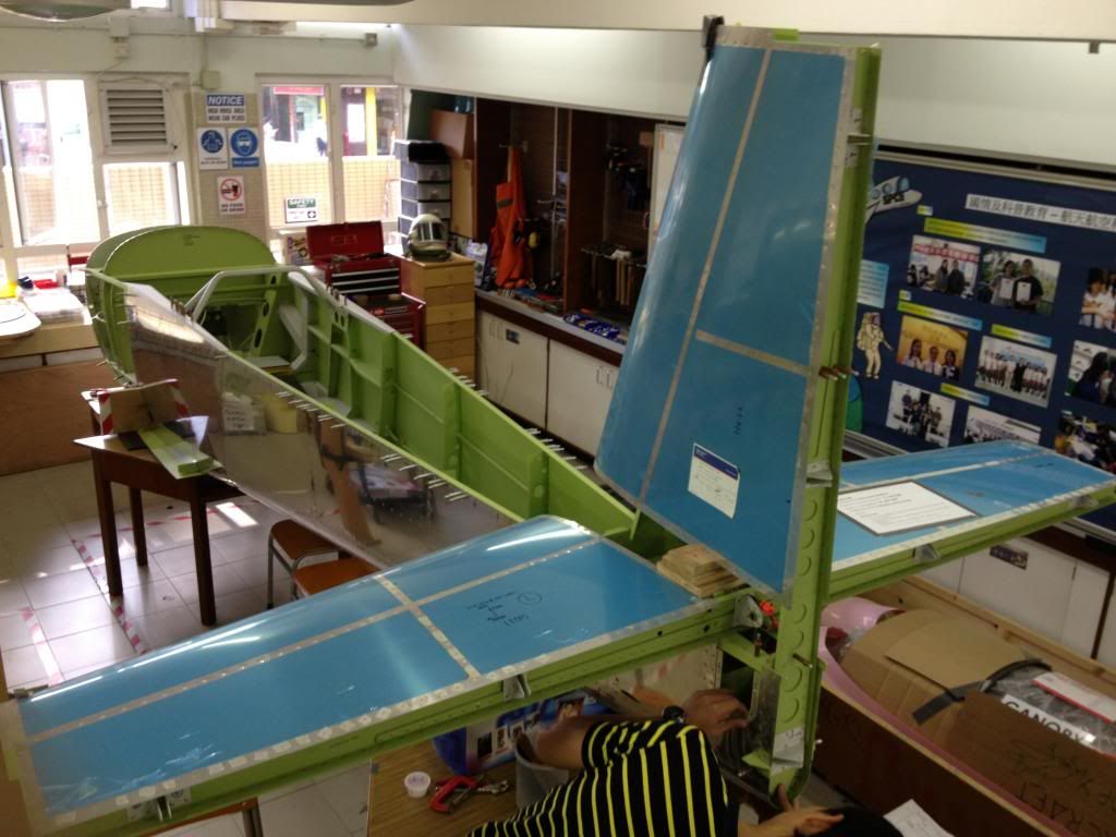

The BIG move
After 4 years of building in a classroom, she got to the point where she won't be able to leave the school if she gets any bigger in size.
We moved the aircraft from downtown Hong Kong to the international airport and that was quite an operation.
The day before move, a team of 10 movers helped with packing up everything for transport. Nothing fancy here, just lots of soft padding and wood structure to form a frame for the fuselage and wings.
