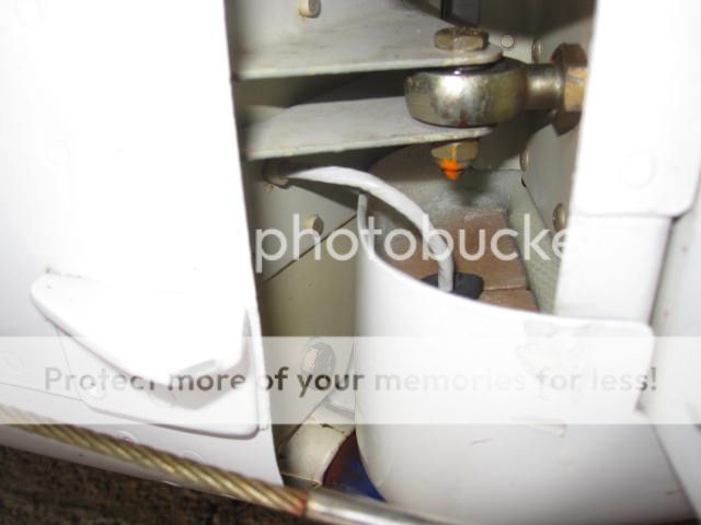

In addition to allowing me the opportunity to move up my annual inspection date to typical "no fly" months, the recent service bulletin and subsequent removal of the tail has given me the opportunity to correct some wrongs when I built.
On my RV7A I didn't want to drill through both the tie down bracket and rudder spar to run the wires for the tail light and strobe. So I had to cockeye it off to one side.

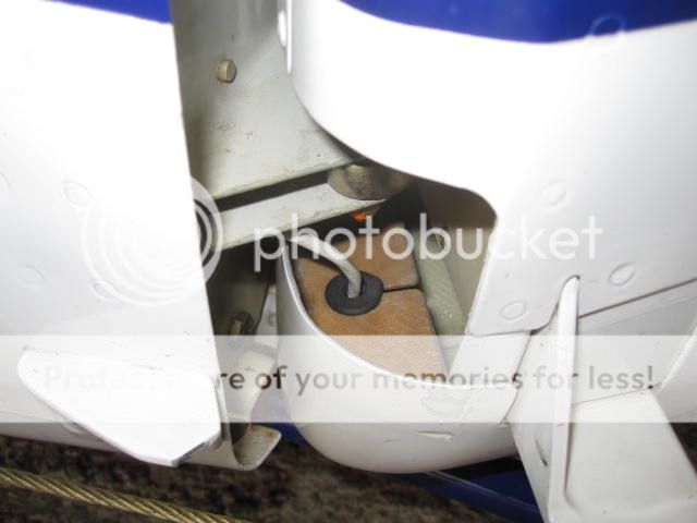

The mistake is I then went into the rudder fairing, choosing to use a grommet for the entry point.
This was dumb for many reasons. First, using the AMP connector means I'd have to cut wires to remove the rudder anyway and, second, you get a lot of flexing in the wire between the rudder and the vertical stabilizer.
I'm thinking about a two inch wide rectangular "slit" in the fairing would make more sense and I'm wondering what other folks have done here?

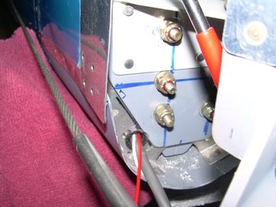

No pics fully assembled, but I drilled through the hinge bracket and used a spacer between the hinge bracket so I could install an adel clamp on the bracket to hold the wires underneath the hinge bracket. I used 3 layers of heat shrink and dropped the wires down the front of the lower fiberglass fairing. The wire seems to stay in place via the adel clamp and the rudder rotates around it, I'm sure it's rubbing on the bottom of the rudder fairing but doubt it rubs through the heat shrink. I left enough extra wire so I can remove the taillight from the rear and disconnect it.
When running wires to a moveable control surface, i always try to run the wires vertical for a short distance on the "fixed" side. This gives more of a rotation of the wires as opposed to bending at one point.

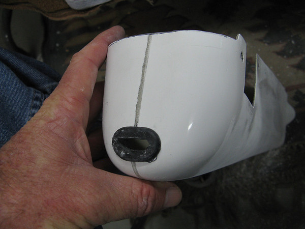

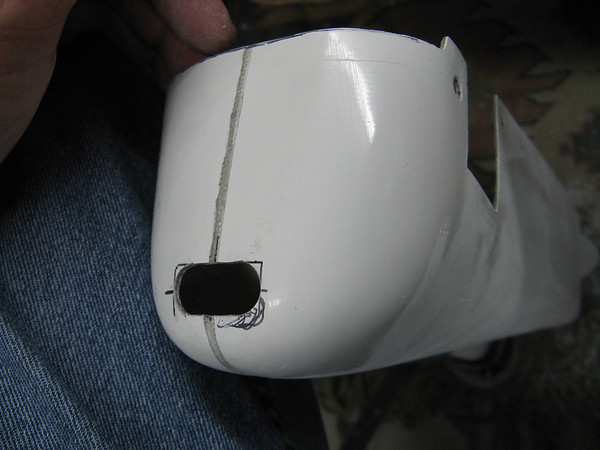

I have the exact same exit as you from the fuselage. Here is the slot I cut in the lower rudder cap, directly across from the exit.
I sized the slot big enough to get a 3 pin Molex connector through the slot.
A rubber grommet can be squished in place in the slot to protect the shielded wires for the tail light and strobe.
