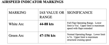

I just put an RV-6A under contract. It has the O-360 Lycoming.
Does anyone know what the speeds are?
Vx,Vy, Best glide and final approach speeds?
I’m not sure if these speeds are different for each plane (I’m new to Experimental aircraft).

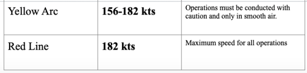

Should be able to click on each image to get larger size, hope this helps as a starting point for you.
I also have an RV-6A with an IO 360 and constant speed prop (hartzell) and think these numbers should get you pretty close for your airplane.
