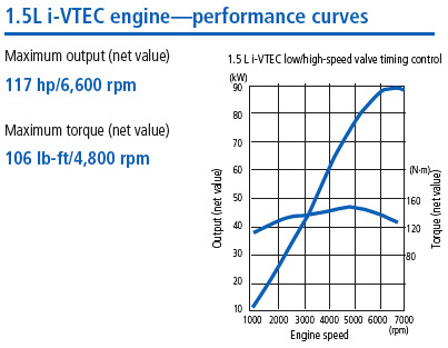

Compare this "Viking Aircraft Engines" chart:
To this Honda Fit chart:
I really doubt these highly tuned engines make factory power levels without a tuned intake and exhaust.

Ok, I'll bite.
Jan,
1. Does the Viking use the stock Honda intake tract?
2. Does the Viking use the stock Honda Exhaust system?
3. Are the power/torque charts on the Viking website actually from the Honda auto engine?
4. Has the Viking engine been dyno tested?
Thanks for your response.

I'm going to interpret the lack of direct response to my question about the charts to mean that they were simply lifted from Honda literature. Similarly, I'll assume there has been no Dyno test of the actual Viking engine. Regarding the thrust test, I AM concerned about weather, prop, scale, and any other sources of measurement error that might have occurred. It might seem like nitpicking, but that's how I am with my money and my hide. Should I trust that the gear drive and other systems were thoroughly engineered/tested, but that a simple fish scale pull test is all that could be provided for the complete engine?
I can't speak for others, but these are some of the thoughts that keep me from throwing a ticker tape parade for the first -12 flight report.
