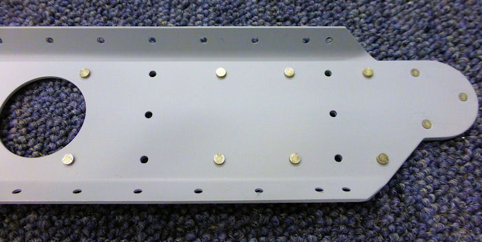

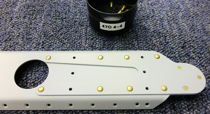

Rivet too short
Page 14-02 Step 7: To rivet the doubler W-1208B to stub spar W-1208C I used AN470AD4-5 instead of AN470AD4-4 as per plan. Both parts are 0.063 which results to a rivet length of 0.315. And that's pretty much 5/16".
I don't know why Van's wants us to use a -4 length rivet. I checked if clearance could be an issue later on, but to me it looks that nothing comes close to the shop heads when assembled to the wing ribs.
Maybe I have overlooked something, but I better feel going with a -5 since these parts are very structural.

The gauge you are showing in the picture is used to determine the correct rivet length before the rivet driven.
That rivet is NOT yet driven. It only may look like. I chekced with the gauge, because it was so obvious that the -4 is too short.
Here's a close-up from above
An here is an image showing a -5 before squeezed.
Any ideas?
Interesting...It looks like the 5 is still coming up a little short. If there's room, try putting a cleco side grip clamp on either side of the hole. This might pull the two pieces together tighter than regular clecoes, and then the 5 might be the right length. If the 5 is very close to being the right length, you might squeeze one rivet as a test and see if the shop head is the proper size using the gauge Rick mentioned.
Here's another option: Do you have a rivet cutter? You can take a 6 and cut it slightly shorter, making it a 5.5 length. If you don't have a rivet cutter, you can accomplish the same thing by shortening the 6 rivet with a sander. Don't make it too long or it will bend and won't set right.
Wow, that is short
Thanks for the close-up pic. I'll have to check my plans notes but I'm guessing that I went with a -5 in that location.
As I learned doing my -7, not all of Van's rivet, screw & bolt call outs are 100% correct. They are correct most of the time. However, like in this case it's worth checking with a gauge if it doesn't look right - not just blindly following the plans.
