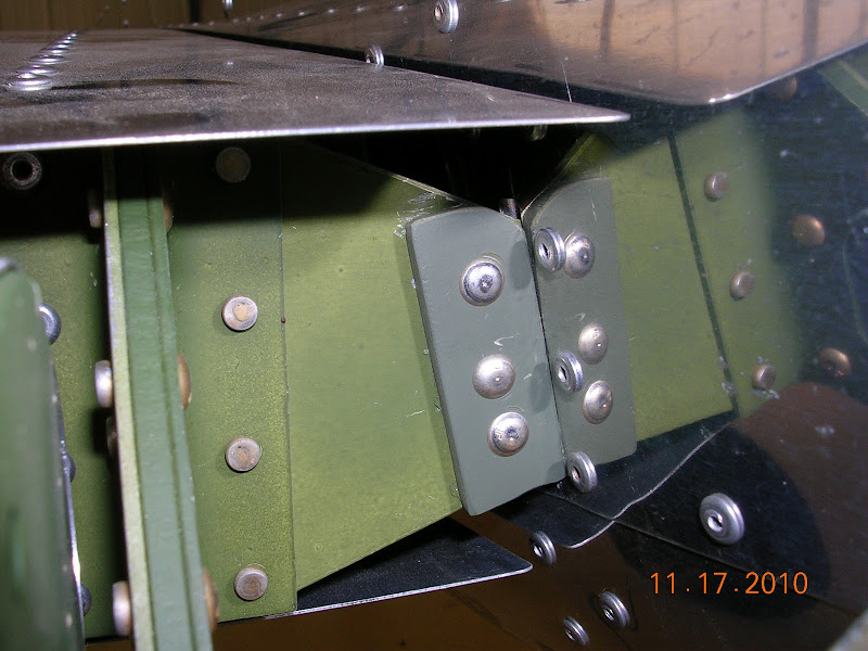

Fore - Aft wing play
My left wing had fore - aft play. The right wing did not. Just a few thousandths play at the wing root will be amplified at the wing tip. The rubber seal can not be depended upon to eliminate the play. Over time, the seal will compress. I riveted a doubler against the aft side of the rear stub spar so that the doubler is up against the fuselage skin. I will take a picture next time I am at the airport.

Eliminate wing fore - aft play
Here is a picture of the doubler that I riveted to the wing rear stub spar to eliminate fore-aft movement of the wing tip. It is the gray colored part with 3 rivets.
