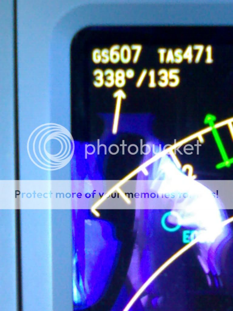

As an example at high altitude, the B777 I fly has a Vne of about 340 knots INDICATED airspeed (dynamic pressure limit). At FL390 we usually see TAS values of over 450 knots, but the indicated speeds are around 260 or so. Not a problem, since we're well under the indicated speed for the airplane. Mach limit is what holds us back up high.

Rvbuilder: As an example at high altitude, the B777 I fly has a Vne of about 340 knots INDICATED airspeed (dynamic pressure limit). At FL390 we usually see TAS values of over 450 knots, but the indicated speeds are around 260 or so. Not a problem, since we're well under the indicated speed for the airplane. Mach limit is what holds us back up high...
If you're showing 260K with a VNE of 360 indicated, your TAS must be over 520 MPH, not near your real redline, which must be near Mach 1, no? Do you have a redline that moves South with increasing density altitude or a manual that shows decreasing redlines with altitude?
Thanks for chiming in,
Hi Pierre,
The numbers I posted earlier about the B777 are typical for econ cruise at altitude. At our cruise altitudes, everything we do is relative to mach number, not IAS or TAS. That's because we're operating well into the area where compressibility in the flow has huge effects on the aerodynamics on the wing.
At FL390 (from memory here) we see around 260 knots IAS at a mach of about .83 to .84. TAS will be in the vicinity of 460 knots, which is 530 mph (like you said). The redline on the airspeed tape at that point will be about mach .87, and we're running up there at mach .84, which is only about 6-7 knots under Vne at altitude. But the B777 is flying at a very efficient point right there, even though we're just a hare below redline.
