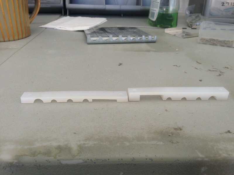

Here's a new request - SOMETHING BETTER FOR ALL THOSE $&@?!! Wires going over the brake pedal assembly!
"New" tunnel wiring brackets
I asked Van's about the new tunnel wiring brackets that come with the ADS-B kit and was advised to order (3) F-1276D brackets to replace the F-1267C I had installed. The three brackets I received were identical in size to the F-1267C brackets I took off. For anyone who has the original and the ADS-B kit brackets, how much taller are the new ones and is the part number on the parts page F-1267D?. So far it looks like a waste of a perfectly good $20 bill.

John,
Someone messed up pulling the parts. The F-1267d part is dramatically different in height from the F-1276c. Completely different!

Let me check this evening, Jim. Probably my fat fingers trying to type on this iPhone. Could very well be the case and I could have jumbled the two digits around.
This should clear up the wiring shields / nylon blocks
Here are photos of the plans, depicting the two wiring shields, along with the taller nylon routing blocks.
If you are ordering these from Van's, order: Quantity of (1) part # F-00049. Quantity of (1) part # F-00050.
Quantity of (3) part # F-1276D. All five items will EASILY fit in a very small padded envelope. Request USPS regular mail in the envelope, and I'd bet postage is only a dollar or two.
Here is the main shield, Van's #F-00049. It is bent by hand on the ends, and fits under the top halves of the first two nylon blocks. Its purpose is to protect the wiring under the flaperon mixer. Unless you made your own, this is a MUST have, in my humble opinion:
Here is a photo of the taller nylon blocks, Van's #1276D. If installing ADS-B and routing the antenna cable to the tail, these are a must have since the original nylon blocks don't allow for enough room. They DO come with the ADS-B kit, if you get the kit from Van's.
And finally, here's a photo of the shield that goes back on the flap handle pivot point, left/pilot side only. Quick install with the two existing bolts. Van's #F-00050
Sorry for any earlier confusion!
