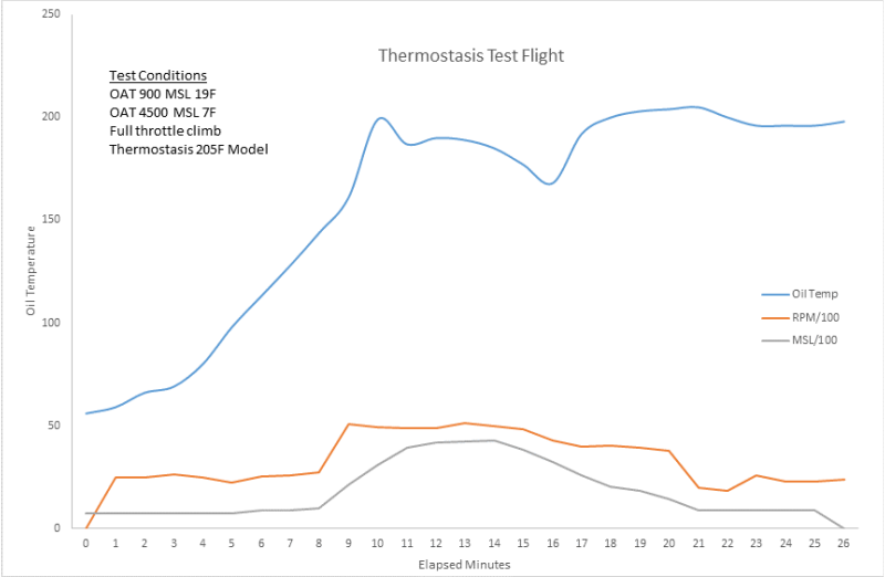

Thanks for being involved. I can tell you for sure that even in 4 degree F temps, the oil gets up to therm value as indicated on the display before closing some and then blending the return oil and causing the indicated temp to fall some.
It does not offer any help in warm weather other than to warm it up faster. Once the therm is closed, you get full flow thru the cooler. I don't feel it hurts even in hot weather, but well worth the cost for quick warm ups at any temps.
If you have installed one, then watch the temp very closely on take off and climb out. Keep watching until it starts to close and then it will stabilize at lower various temps depending on demand and outside air temps.

Any idea why this doesn't jive with the experience John is having?

Power demand is an important factor. Notice I was not demanding much power, so less warm oil was involved with the blending on return, and oil going even slower thru the cooler makes the blend even cooler. If I run the engine harder, the return oil does warm up more on return to engine.

No reason to. Oil in the tank is approx. therm value, and that is all that is important. Agree, your test could warm up the oil at then engine, but it is just not important.
That would make sense but look at the data chart.
It shows oil temp at 200 in a power off decent.... that would be a low power demand situation.....
Scott - -
If throttle is greatly reduced in cold, very cold, weather, the temps will back back down until the therm opens up and no oil goes thru the cooler. In moderate or warm weather, it will not change as much. You have to understand all the oil goes thru the therm one direction or the other, or a blend going back to engine. Once the cooler oil is blended in, the temps will lower going back to the engine.
I would like to see you add a temporary temp sender from the tank. With the Thermostasis, I think you will see the tank temp remain fairly constant. In hot weather, it will just climb due to cooler not being able to handle it.
