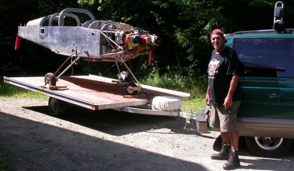

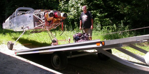

Having owned a Europa Mono Wheel Motor Glider I will speak from a small bit of experience in trailering an aircraft. The Europe being an English designed aircraft was built so that it could be trailered and operated off of, in some cases a cow pasture, minimum improved airstrips and to allow one to stop at the car gas pump on the way to the airport to fill up and in general lower the extremely high cost for flying in England. There is a Europa forum available in the Matronix list of forums. I suggest you go and sign up there and search and read up on their trailering posts.
For over 2 years I trailered from my home to McCollum airport in Atlanta. It was a 30 minute drive and required 1 hour before I could get airborne. I keep the aircraft in my garage because I couldn't get any affordable hangar space in the Atlanta area at the time. After the 2 years I finally found affordable space at Stockmar 20GA. It was a one hour drive and usually took me 30 minutes before I could get airborne. So in this example you can see the time required before I could fly is the same. So from a time to fly perspective their wasn't any benefit. If was easier to work on the plane because it was home every night in your garage. You have the luxury of purchasing fuel at the local ethanol free gas station.
It's a cool neighbor factor when one keeps their flyable aircraft at home. I had a Europa factory built/sold trailer made for my specifically aircraft nothing home grown. It was not uncommon to get some sorta of trailer rash when trailering. It was fun to see the cars pass you and all the kids in the passing car would look and point as you went down the road towing your aircraft.
The trailers that you see in the glider community are exceptional for their specific aircraft. I have never seen anyone make a really good Europa trailer similar in design that came close to what the glider community utilizes. This is not to say it can't be done, but I never saw one.
One thing you have to keep in mind is your aircraft is not meant to be bounced a lot when we fly. Sure the occasional landing bounce but nothing like driving down the road in our cars. I was very aware of every bump in the road when I was trailering my Europa. Even with an excellent suspension on a trailer you will get bounced around. Don't believe me...go stand up in a trailer and let someone drive you down the road and see how much you get bounced around as apposed to setting in your car driving the same route. Trust me it will be a rough ride for your aircraft, and the last thing you will want to do is expose your baby to that kind of bouncing around. I will post a couple of pics in another post. Needless to say I vote for a hangar but trailering can be done.

Europa Trailer Suspension
Steve,
How would you deal with the trailer suspension? As I see it, you have 3 sets of masses and springs of different stiffness - trailer suspension taking all the load, the weight of the plane on its undercarriage, plus an engine hanging off flexible engine mounts - that will all interact to stress the airframe with every bump in the road. Gliders have the advantage of not having a heavy engine bouncing around in the system. Sounds like a complex problem in dynamics.
As far as covering the trailer goes, it should be possible to use a canvas cover pulled over a series of lightweight tubular aluminium or steel frames that fix to the trailer chassis. The frames would be removable to get the plane on and off.
The suspension on the Europa is elastomeric (SP) trailing arm type and much better suited for the light aircraft weight.
Steve,
do you think the engine mount will be getting stronger suspension hits while in the trailer than it would while in the air?
I don't know. I think it depends on how the different masses and spring stiffnesses interact, and whether there is any risk of developing resonance in the system. If that happens, then stresses would be magnified. However, if the trailer suspension is well damped, then there probably wouldn't be a problem, but I don't know enough about it to be sure. Just enough to be careful.
