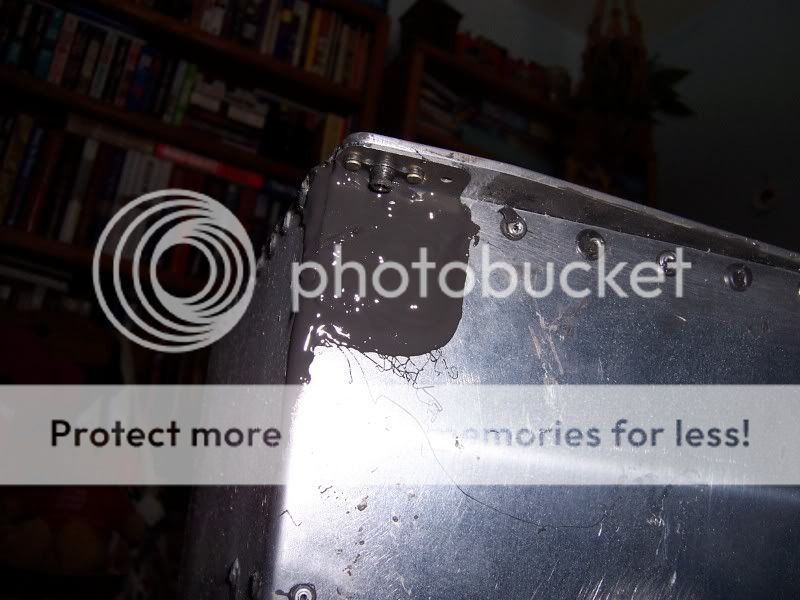

Decided to get it done. I have yet to paint touch-up, and re-install, but would advise it will take about 8 hours total to finish, if a flying plane. These are just some of the pictures to give you an idea of the job. Not overly messy. I put a fair amount on the inside of the brackets, and when I put them on a lot pushed out. Dipped/Covered the rivets as instructed also. Together there was enough extra to smooth out the extra all over the surface to seal up everything. Don't expect a leak problem.
I was prepared, and found out the one mix was able to do both job ( seal front plate also ).

I did mine this morning as well, since I had my tank still out with the sender plate still not attached, it took all o about an hour maybe, no tricks or problems, easy task. Looks like I slop on a lot more stinky stuff than John does. I used the whole jar, sealed the inside with a blob as well as the outside. Will use the other jar to seal the sender plate, then it is on to the test for leaks phase..

Overuse of Devil's snot??
I'm just curious about the smearing of Devil's snot all over the outside of the added brackets--Doesn't seem like that is part of the destructions--are you suffering from lack of faith here?
My answer - -
It was oozing out anyway, so just smoothed it up, and thought it looked better that way. After texture paint, will look fine. Not sure the instructions called for it under the bracket, but I did, and feel it will seal it better.
John Bender
My tank
I am lucky in that the top of my tank is not yet installed and doing this modification was not as complicated. I agree with putting the sealant under the new piece and covering the outside. I will also spend some time making sure each rivet inside is coated well. Coating the rivets as they are inserted an set is per instructions and will help with avoiding any leaks.

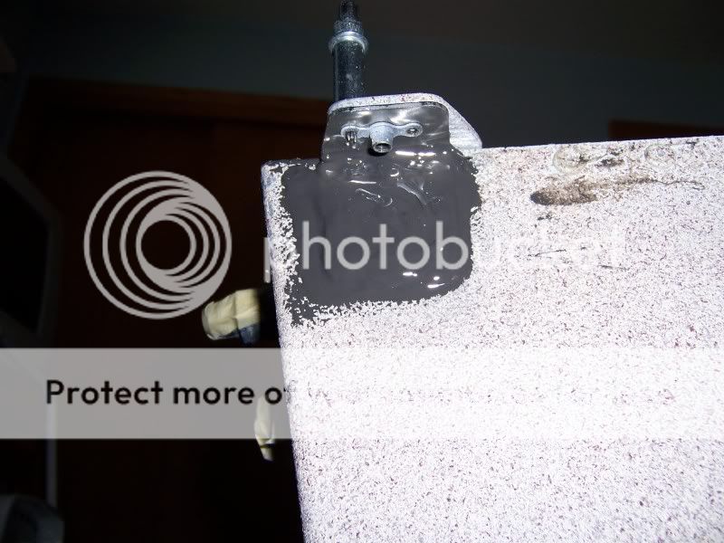

Probably overkill for sure, but as you can see, I smeared that **** all over the seam area as well, unlike Mr Bender who had his all tidy. What the heck, it is free and don't add that much weight to the plane, and when I paint it and upholster it, nobody will know or care.
[/IMG]
Hey, Don
You might have a problem you should mix the tank sealant until it's a uniform shade of gray I see white areas.
Did you build the whole tank mixing sealant like that? HMMMMMMMMMMMMMM
That was from smearing my finger on the bottom of the cup of snot to use it all up. Photo makes it look worse than it really is, and it has set up OK.
GET it right boys!! It is "GOO" and NOT "snot". The later runs too much. Only has to seal. Does not have to look good on the bottom. Merry Christmas!! Gotta love this forum.

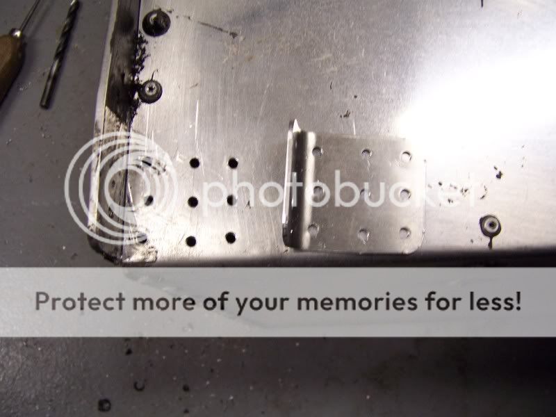

Anybody have any info on the unused hole? I think they decided a rivet is not needed but I am going to put a flush AN 4 in there anyway. just don't like vacant holes.
Hey Doug - -
Only provided 4 rivets, so we are assuming it might be a tooling hole, but only a guess. Can't see where it would hurt to put a rivet in it.
John Bender
extra hole
My take on the addition hole at the bottom left bracket was there was room for some additional security of the bracket to the heavy mount strip. I put in a flush rivet there and it did not hurt a thing.;)
