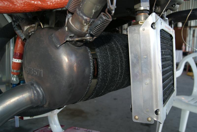

A theory I have is radiant heat from the muffler is diminishing the cooling capacity / efficiency of the oil cooler. The muffler is about 1 1/4” away from the oil cooler. As I understand it, and in talking with qualified engineers air flow does not reduce the effect radiant heat has on an object. I decided to add a fiberglass heat wrap barrier to the muffler.
The above picture shows the muffler proximity to the oil cooler.
Here are the results of the test after the heat barrier was installed.
4,800 RPM, OAT 75F, Oil temp: 195F
5,000 RPM, OAT 75F, Oil temp: 209F
5,200 RPM, OAT 75F, Oil temp: 215F
5,400 RPM, OAT 75F, Oil temp: 222F
5,400 RPM, OAT 85F, Oil temp: 230F
It appears I might be onto something here as the temps are definately lower with just a minimal amount of exhaust wrap. I will post the results of further Non-Van Aircraft Approved Tinkering.
![RV-12_Oil_cooler__Muffler__Medium_.jpg](/community/proxy.php?image=http%3A%2F%2Fj.b5z.net%2Fi%2Fu%2F2048250%2Fi%2FRV-12_Oil_cooler__Muffler__Medium_.jpg&hash=7b447139a214cd6787d83dd3f23b7ea2)
