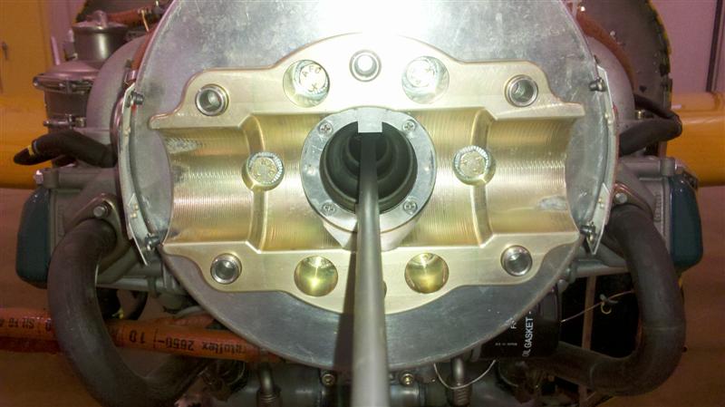

Here are the pics of the hub and blade after 50 hours of flying. The dark spots on the hub are where the blades were moving and chafing in flight. The chafing is particularly concerning because the composite blade is taking all of the force in this one area instead of the entire area where the clamping force would disburse the energy.

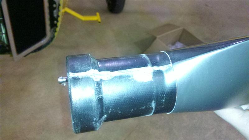

In this picture disregard the obvious white line. This is the flash reflection and the where the factory ground the "mold seams" of the composite prop. The area I am concerned about is below the obvious mold "flashing" and oliptical matching the hub wear. Concentrating energy in one area on a composite structure is not a good thing, IMHO.
I can only comment on what my hub looks like, and after 175 hours there are no wear areas as seen in these pictures. Please understand this information is "raw data" and you should take it for what it is worth.
If you are flying an RV-12 with the Sensenich prop please inspect it ASAP. If the prop is tight in the hub then fly the heck out of like I am. If it is loose, call Sensenich FOR A REPLACEMENT hub.

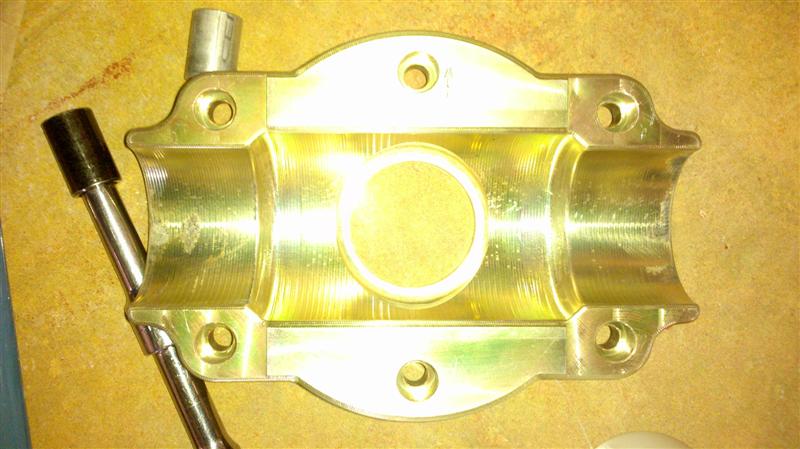

I removed my prop and hub today. Took photos of the wear marks on the hubs. You can see them on my blog entry for today. They are remarkably similar to the pictures earlier in this thread.
My hub serial number is: 281748 and was the gold color. Mike from Sensenich told me the new hubs are black in color and have been trouble free.

Sensenich has made their choice. It is apparent that the machined hubs were initially built with an excessive tolerance. The non-machine made blades are of course built to a tolerance as well but not one as controllable as the machine made hub. When the limit of the hub tolerance met the limit of the blade tolerance, clamping no longer was possible. How else could some hubs work while others did not. Sensenich has built a new hub with a lower tolerance to guarantee the blade clamping.

In talking with Mike at Sensenich last week, the black hubs are not necessarily new. They are re-machining the returned gold B hubs and taking .008 off the mating faces. Then they send them out for the black anodizing. Apparently not re-stamping them.
