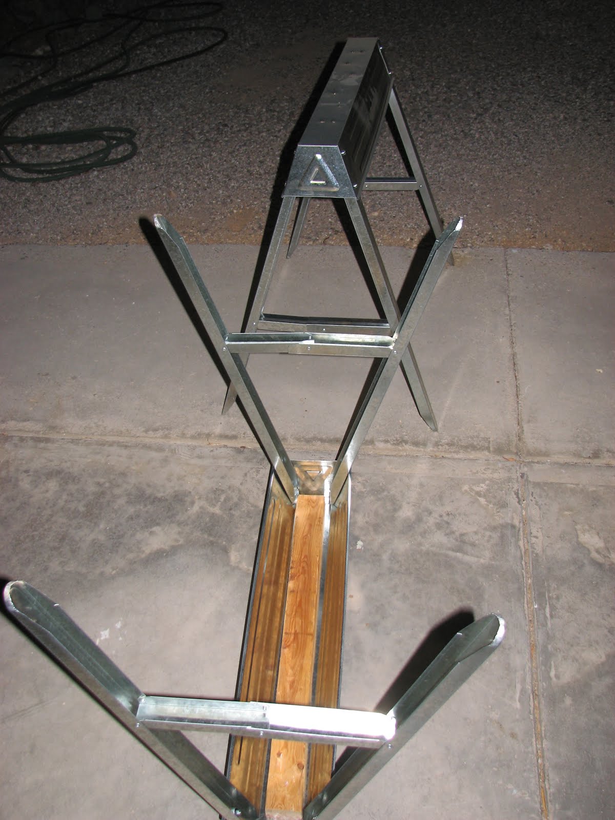

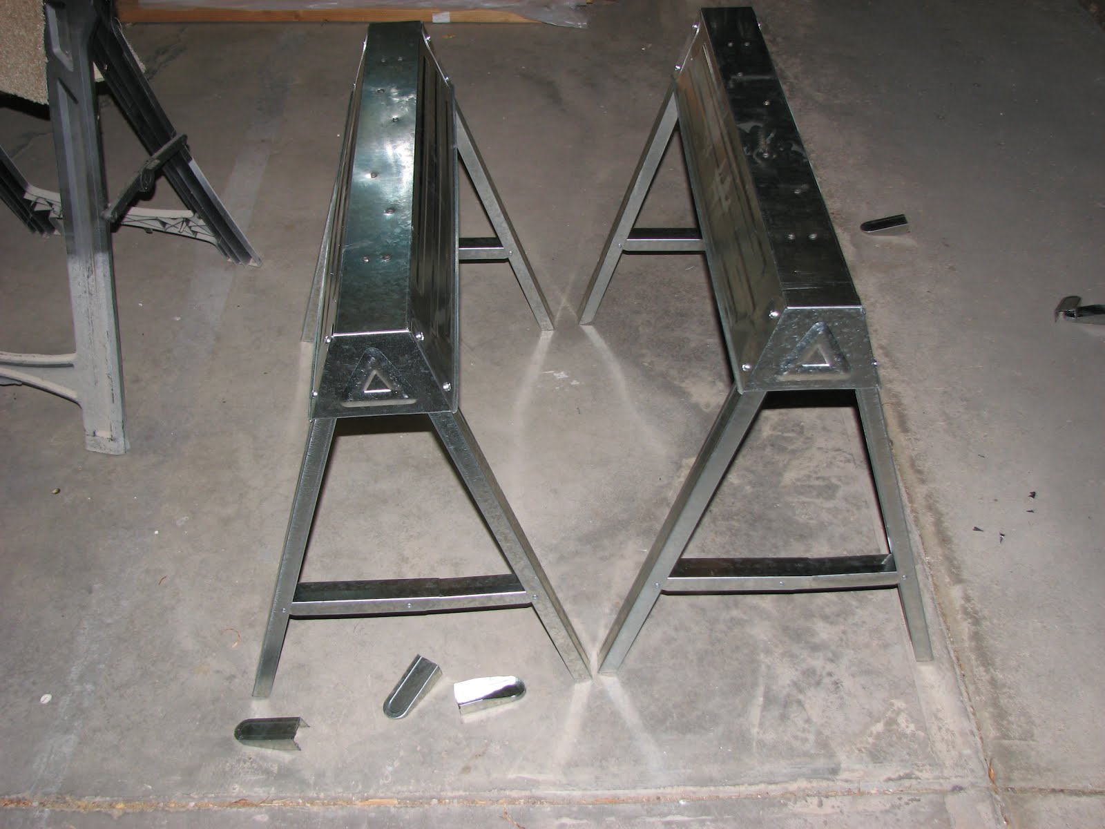

I settled for these, $32 at HF, and you can clip a coupon for 20 % off in most magazines. They do require about four inches cut from the bottom of the legs, but that took only a couple minutes with a hot saw. They are rated at 1000 lbs each, fold for storage, and are just the right length for an RV12 without alteration. I figured if I was going to have an RV12, then these would just be part of my maintenance supplies.
