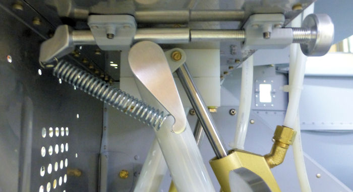

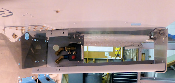

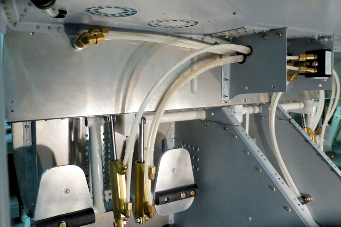

Parking Brake Mod
http://www.joesrv12.com/Builder Log/bl_32_02.htm
That's a pretty sharp edge to bang your knees on in an accident. you might want to re-visit that.

The changes in the photo is only part of many changes.
The bottom of the tray is part of the structural design of the mount for the Jab 3300 engine. See the bottom doublers at the engine mount.

I purchased the parking brake specifically for the 12 and I get it with the wrong fittings.. AN types for aluminium tubing.
Despite the high cost of the thing VANs forces me to buy 179CA fittings for nylon tubing and I cannot return the wrong fittings. }#<<>$%
Getting very expensive to brake these days.
Did you have same prioblem ?
