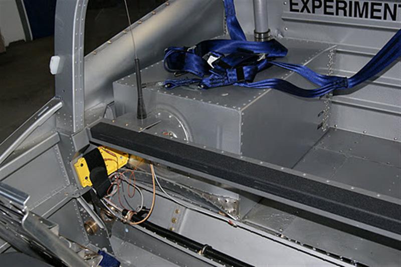

Here is the picture I took of the plane. The plane contacted the runway after take off and hit with a 5 or 6 degree nose down angle. At that angle the nose gear gave way and the main gears rotated aft taking the center section with it. The tank is attached to the center section, and this in turn tore open the tank. This is the only time we (or Vans) know of the tank being breached. This accident caused this specific problem.

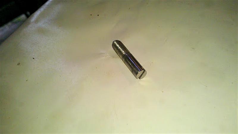

Okay, that is the issue. Here is the "unofficial" fix.
Replace the two bolts that secure the fuel tank to the center section with a modified "headless" bolt. I took a hack saw and cut the head off a bolt the next size longer and created a slot with the hacksaw. The aft support bolt holds the tank secure, IMHO. I removed the old bolts and installed the new "headless" bolts during my condition inspection, with no fuel in the tank.

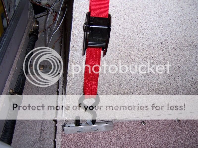

Next there is the issue of becoming inverted during an incident and having the tank become " loose" in the baggage area due to the headless bolts. The best fix that I can think of is a strap holding the tank down to the baggage floor independent of the center section.
Here is the picture....
![RV-12_Tank1__Medium_.jpg](/community/proxy.php?image=http%3A%2F%2Fj.b5z.net%2Fi%2Fu%2F2048250%2Fi%2FRV-12_Tank1__Medium_.jpg&hash=7a3d04605ff943f76261aadff579bcf2)
![RV-12_Tank__Medium_.jpg](/community/proxy.php?image=http%3A%2F%2Fj.b5z.net%2Fi%2Fu%2F2048250%2Fi%2FRV-12_Tank__Medium_.jpg&hash=bc5f8a548884df93d8607d2244fc9716)

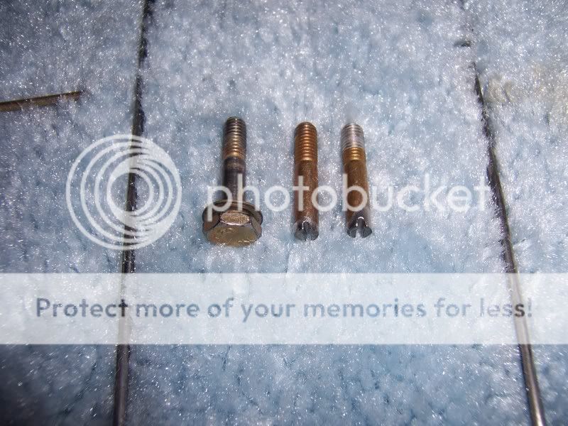

![RV-12_Tank_Bolt__Medium_.jpg](/community/proxy.php?image=http%3A%2F%2Fj.b5z.net%2Fi%2Fu%2F2048250%2Fi%2FRV-12_Tank_Bolt__Medium_.jpg&hash=69d1e5b6cf4926b638140aca00577d49)
