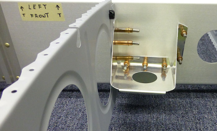

After talking with team X at Garmin I decided to put the GMU 22 Magnetometer in the wing to avoid interference from the other electronics in the aircraft, with the battery in the tailcone I need a alternate location for the Magnetometer.
To mount the GMU 22 Magnetometer in the wing I need to know the Dihedral and the angle of attach of the RV 12 Wing.
If anyone can help it will be appreciated.

Joe, as Larry said, you want the angle of incidence which is relative to a line through the fuselage, not the relative wind. Don't know what the number is for the -12, although 4 deg is probably in the ballpark.
Joe, this is a don't overthink it type of deal. It is good for the magnetometer to be around level on average. Airplane designers would be expected to want the fuselage to be around level in cruise, for drag reasons if nothing else. The angle between the fuselage and the wing is the incidence, so that is what you want to know. Seconds of arc don't matter much here. The fuselage angle to level will vary with speed and loading. Small heading errors due to the magnetometer not being quite level will be of small consequence.
I would just set it parallel to the cockpit rail and not worry about what the wing angle of incidence is. That should be level enough.

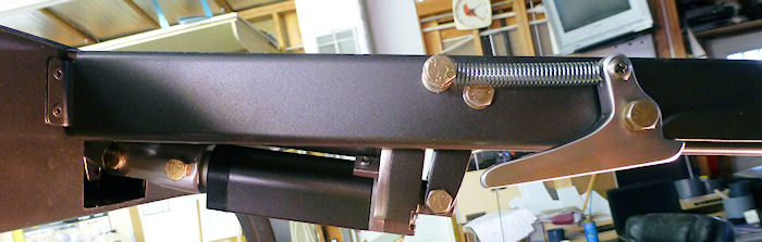

This is too close to my canopy lock.

I had a talk with Garmin tech support yesterday, they really prefer the magnetometer in the wing.
Garmin sad that the magnetometer should be within a 2 or 3° from level.
I installed a tray in the wing 90° to the Spar and 5° down to adjust for the wing dihedral.
The hole for the magnetometer is not to size, I will open it when I get the install kit I ordered from Stein Air.
Vans RV12 has removable wings so I think that is why they installed it in the second best location the tail.
Removing the wings and taking the aircraft to the airport on a trailer every time I want to go flying don't work for me. ( the wings will only come off to get it to the airport )
I have my fuel tanks in the wings and will be installing a six cylinder engine that weights more than the Rotax, causing me to put the battery in the tail.
The high amp load from the charging system makes it to difficult to shield the magnetic inference and the pitch servo adds to the problem.
