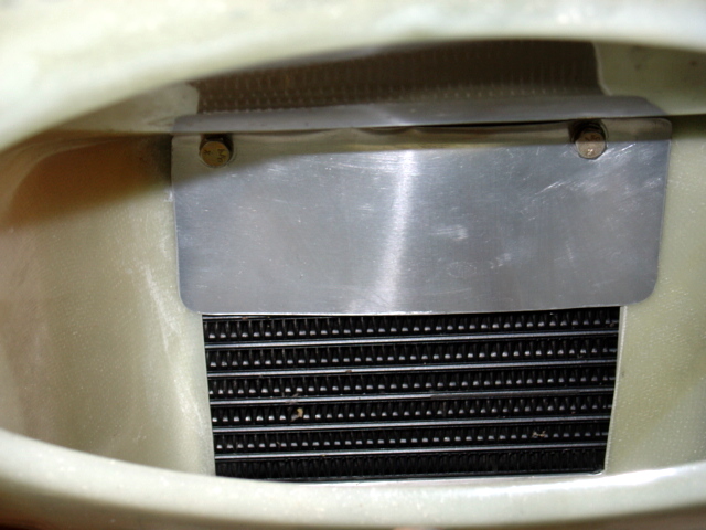

Oil Temps - I added a 2 1/2" (measured from center of hole down to edge of plate) oil cooler cover plate. It is held in place by the same #3 bolts that hold the cooler in place. Very simple. Now the temps are around 195 - 210F

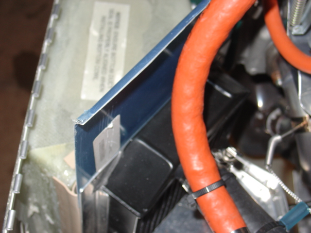

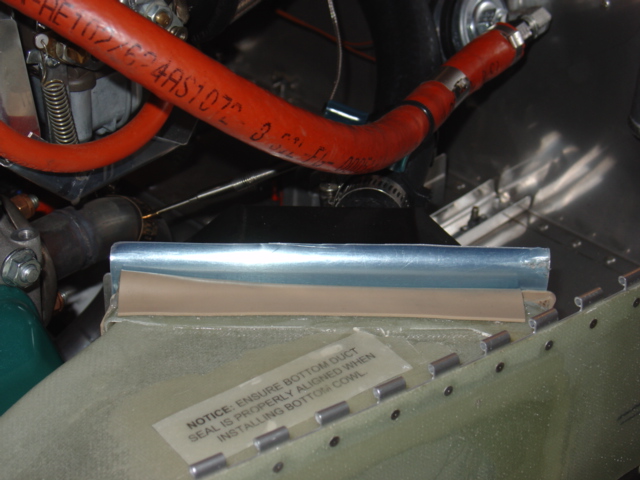

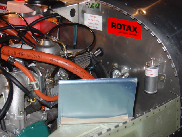

Cabin Heat - I added a simple 7 1/2' x 5 1/2" .020 plate to the radiator that you can put in without removing the lower cowling. Simply slip it in between the gasket and the radiator flange. The plate has a 90 bend in it so it cannot slip down any farther. This covers up the top 1/4 of the radiator. Very simple and it works! CHTs are 185- 202F Cabin heat is warm!
Here is the radiator cover prototype. While it did not move in flight, Marty & I thought it would be best to add flanges on the top & sides on the "production model" to keep it from moving.

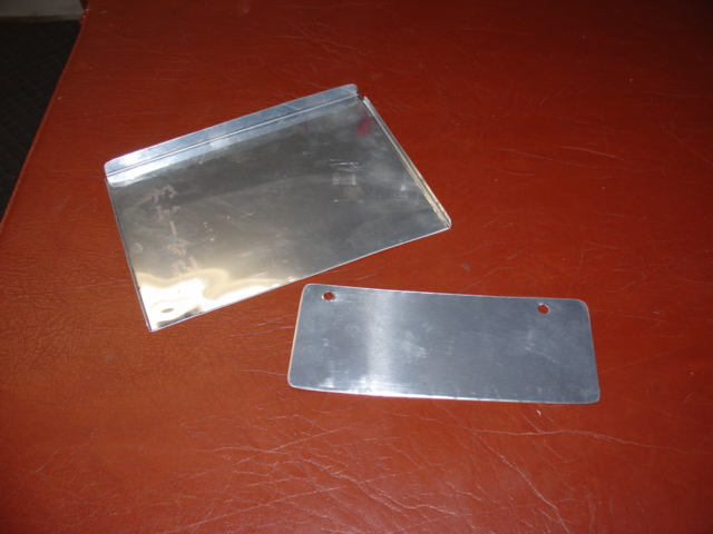

Here are the completed parts.
![RV-12_Oil_Cover.jpg](/community/proxy.php?image=http%3A%2F%2Fj.b5z.net%2Fi%2Fu%2F2048250%2Fi%2FRV-12_Oil_Cover.jpg&hash=bc15c054655b9ceb7bf5650be0c07c94)
