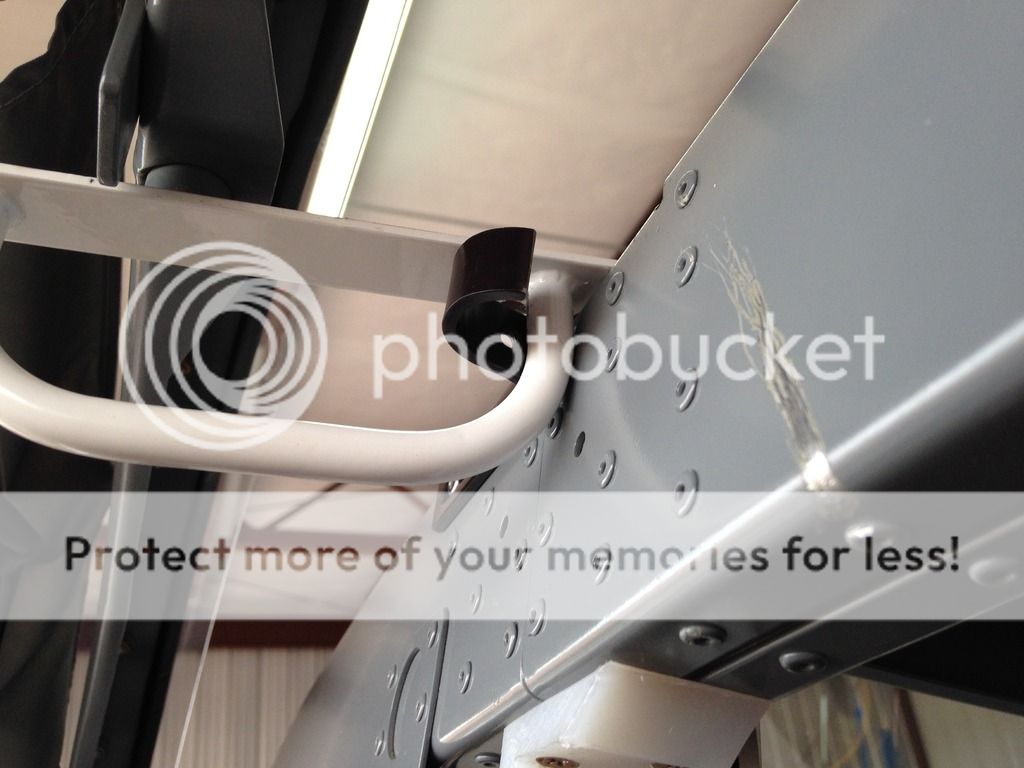

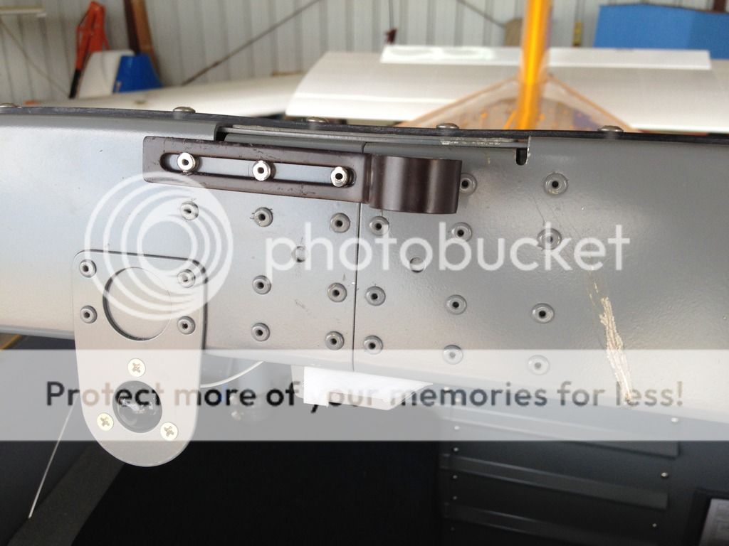

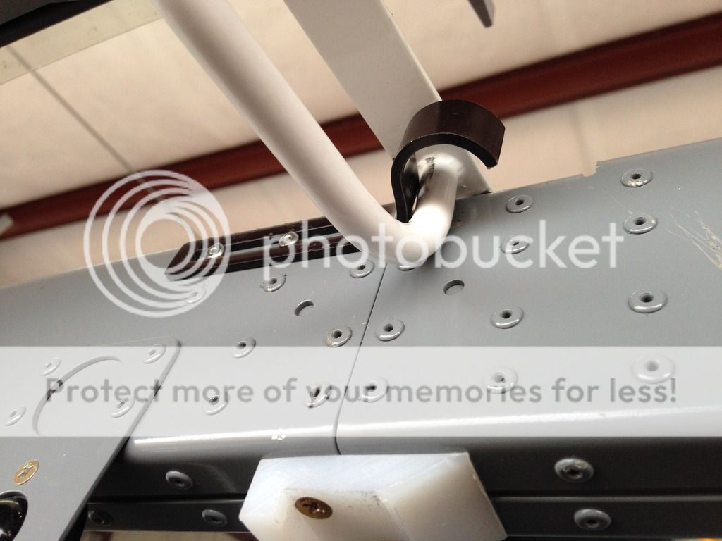

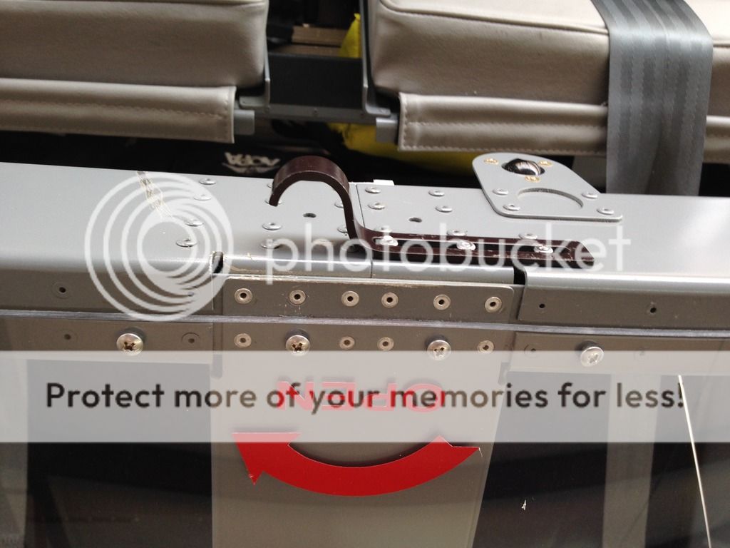

Sitting in the plane today, I came up with this idea to keep the canopy from opening. Have not actually made it yet. Bend an 1/8" x 1" aluminum bar and fasten one end of it to the forward side of the roll bar so that the other end extends 1" past center. When the canopy is in the ventilation position, the aluminum bar will be inside of the handle loop, preventing the canopy from opening further. There is no extra step for the pilot to forget. Vinyl caps are available to fit the bar.
Nice. If that works it could be the most elegant solution yet. Can't wait to get to the hangar and have a look to see how these ideas look "in person".
This is solution 101 based upon Mich48041's concept. I found that his idea needed modified since the socket for the handle in the canopy front would hit his angle. Solution is to curve the bracket to miss the socket and provide a "catch pocket" for the handle. I just drilled out the top three rivets left of the rollbar seam and used 3, 4-6 pulled rivets for a first install. If satisfied I may replace with larger structural rivets or thread for bolts. I just modified a curtain rod support bracket for this. Seems to work well. Hopefully this pictures will explain it all.

Flew with the safety catch today. You quickly get the feel to engage and disengage the catch about like fully latching the canopy. Tested with a full runup and it works great but I still plan to fully latch for the short runup time before takeoff just in case during taxi there are any latch position movements. From scratch I would probably use aluminum and rather than a slot, match drill for the three rivets but hey, the bracket was in my junk box needing only minor modifications. Will paint to match roll bar and probably round corners more and dip in PlastiCoat to protect the handle power coat.
