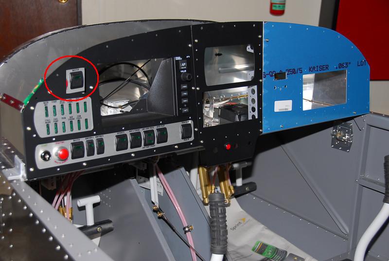

I ended up not liking the "pump on" all the time. I added the following switch to trun the pump on and off.
Fuel pump switch - revisited
Up until now, I have been of the opinion that not having a seperate switch for the electric fuel pump was OK with me. But, there always seems like there is something I want to do on the Dynons or GPS whenever I go to the airplane. So, I am continually pulling and reinstalling the fuel pump fuse. I have made my GPS non-removeable so if I want to put in a flight plan before flight, I will be pulling the fuse again. Also, this is not conducive to safety, as a pilot can forget to put the fuse back in, just like he can forget to switch on the pump if there was a switch. The engine will start and run, but the avionics would likely overheat on a hot day.
Anyway, enough probably has been said on this topic, there is a lot of great information in this thread, and folks can make up their own mind.
I am planning to install a switch, but I can not quite yet as I need to fly off my flight test cards first.
Here is where I think I will put the switch:
The switch would be guarded in the ON position. The label works for both the valve and the switch - down is ON. And, the position of the switch makes it easy to check when you check the fuel valve on the takeoff and landing checklists.
Since the wire bundle is directly below it will be an easy matter to cut and put a male and female spade on the red fuel pump wire. The switch can then be installed with spade connectors to make removal of the inspection panel easy.
Tony

Switch location...
Tony, If you want to put a switch, put it on the panel where all the other airplanes have it. One day is one day where another pilot is going to fly your plane, when that motor misses a beat and in a panic he is looking for the boost pump switch will he remember to look on the floor??? No he will scan the panel for the switch...just my 2cents!
I like Geico's position, i am going to steal his idea! :D
Kind Regards,
Rudi

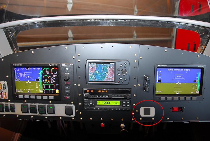

Rudi, you make a good case. Now, where-oh-where on this panel to put it. I can't use Larry's idea because I have the autopilot. Maybe above the fuse panel. It would be in plain site and there is plenty of room behind the panel, plus the red fuel pump wire is easy to tap into. You can see it in the lower wire bundle in this picture.
[url=http://tonytessitore.smugmug.com/RV-12-Project-N577RV/Avionics/10000342_ViPnR#739889731_eks9Y-A-LB][/URL]
Tony
Tony
Hi Tony,
Hmm I am not aware of Autopilot issues with the proposed position, becuase we are not there yet. What is the problem with Geiko's position and AP?
If there are problems then Maybe you want to mimic the switch panel on the left panel and put it with the same spacing on the right panel. If you want to be fancy mimic the switch and grey border too it will look like it was designed like that. Below is what I think stolen from your pics if there is a AP position problem. But you can Mimic the same on top of the Fuses, just keep symmetry and type in mind and it will look good.

Rudi, Larry's switch occupies the hole that is used for the autopilot disconnect button. The red button can be seen in the pictures.
Tony
I noticed the circuit board for the switch panel has an empty switch position between the IGN B and Avionics switches. The board's silk screening in this location says "Fuel Pump". I think it goes to a seperate pin on the fuselage connector. I wonder if this was the original design and was abandoned, or if the designer was just leaving his options open.
It looks like it would be possible with a little reverse engineering to put the switch there. Seems like a logical order for the switches, but in my opinion its kinda close to other switches that you wouldn't want to turn off unintentionally in an emergency.
