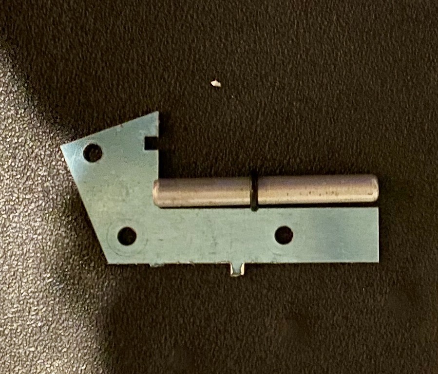

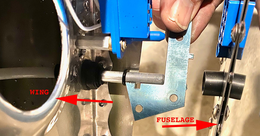

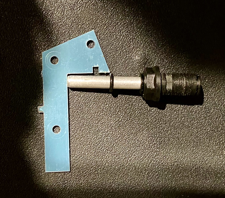

One last question (I hope)
As shown in the image with labels, the depth of insertion after installing the wing with both pins engaged shows that the aluminum tube must be too long since the distance from the fuselage end of the tube to the O-ring is too far. As shown by another image, the length of the tube matches that prescribed by the template. The other image shows the depth of insertion when I shove the tube into the wing receiver. It is identical to the depth shown after wing installation. The instructions state that I should remove 1/32 ths of an inch from the length, but it looks to me like I need to remove a lot more than that.
Of note, the leak test is fine, and the wing is fully engaged by the pins in the fuselage.
So, I assume I need to remove enough of the length of the tube to match the gauge. That appears to be more like a 1/4" . Am I missing something?
I ended up cutting off about 1/4" of the aluminum tube. I have not calibrated my AOA yet or checked it for leaks.
Once I cut the tube short enough to match the depth gauge, it was too short and it no longer engages the fuselage push-to-connect fitting fully, and leaks. Making a new tube and going to ignore the gauge.
