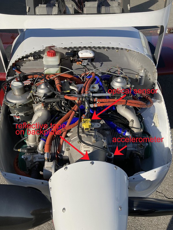

I just purchased one as well and am waiting for it to be shipped. I plan to provide the service to others. So if anyone needs to balance I am in Eastern Washington. I will be doing them for free for a short time to learn the art and gain experience.
seagull,
Can you provide some pictures of your setup and some instructions on the process?
The instructions are not difficult but more than I want to write here. You can find manuals online for the balancer.
To state it simply, you mount the optical sensor and accelerometer to the engine in the correct locations and alignment > run the engine at cruise RPM > take reading > shutdown > add weights as recommended by the balancer > repeat. After each test the ips will be reduced. When you are at the ips level that is acceptable to you remove test weights and mount permanent weight.
Can you tell us what the “test weights” are and how they’re applied?
The test weights are normal flat washers. Stack a few up to get the total grams required. In the case of the RV-12 the "test" weights are added under the head of the screws that attach the spinner to the backplate (10). typically the balancer will split the total weight between 2 adjoining screws. The final weight is calculated for a smaller diameter and added to the back plate with a bolt and nut. You drill the hole at the recommended position.
Thanks very much. It’s something I’ve been wondering about- simple when you know the answer.
