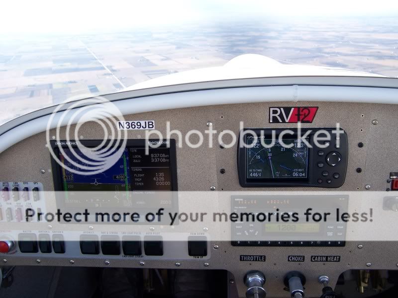

Super day in Iowa for early November. Turned over 200 on the way back from a trip to the Mississippi River.

At the speed I was going, it was showing about 4.9 GPH of high test auto fuel most of the time. I would guess I was at about 75 - 80% throttle. The picture shows 112 knots indicated. I was able to get 126 knots WOT earlier that day. At WOT, it shows about 5.5 GPH.

Uhh, I hope you are EAB (or at sufficient altitude/atmospheric conditions), because otherwise you just posted on a public forum that your plane is not airworthy anymore.
"A maximum airspeed in level flight with maximum continuous power (VH) of not more than 120 knots CAS under standard atmospheric conditions at sea level."

It is misunderstood - - - - a bunch ! The spec's you quoted are correct. YOU MUST understand, they are at MAX GROSS and at SEA LEVEL. If lighter, and higher, it will go beyond 120 knots. IT WILL NOT if at gross and as near to sea level as you can get for your area. Very happy you asked that question. Seems to be very much misunderstood !

With Painted pants. Weather, density, etc, all have an influence. Some days I can not get to 120 knots WOT, even by myself. At moderate cruise of say 125 MPH ( 108 knots ), I see 25 MPG usually. Not bad at all. Fun plane for just going no where in particular ( which is what I do a lot ) !
