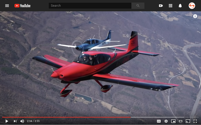

It's been a couple of days since it was published, so maybe you've already seen it - but AOPA did a bit of a fun fly-off drag race between their sweepstakes RV-10 and an SR-22 and posted a video. More details of the comparison will be in the AOPA Pilot magazine per Dave Hirschman from AOPA. Many people are asking the same sorts of questions posted earlier in this thread, of course. Click the image to watch the YouTube video.
The Cirrus took off and when clear, I did also. When I returned home my wife's first comment was how fast the RV was in comparison to the Cirrus on TO, commenting my run was less than half the length of the Cirrus! There is the RV Grin!
The wing loading on a Cirrus is around 23.5 lb/sq ft vs the RV10 of 17.5 lb/sq ft or 25% more. That's your shorter take-off and climb perfomrance; probably at the expense of some stability in wind.

Gee, no mention of price, maintenance costs, fuel flow and more. It didn?t look like a tie to me.
Remember that Cirrus is a MAJOR advertiser with AOPA and get out the salt shaker.

There are lots of unmentioned inequalities. The Cirrus (at least current ones) carry more fuel, go faster, ride better in turbulence, than the RV. On the plus side for the RV, I'd much rather maintain a Lycoming 540 than that Continental 550.
And then there's the cost difference.
Don't forget, there are still a LOT of people out there who refuse to even look at an E-AB, not to mention fly or own one.
AOPA has to get past that bias and that video will go a long way towards doing that. They hit the highlights and if someone is really interested, they will investigate further.

They carry more fuel because they USE more fuel.
Apples to apples, the cirrus is but a few knots faster, at the same altitudes...

It would have been interesting if AOPA included an efficiency test. Climb to 10,000, set fuel flow to 12 GPH, and see which airplane is faster. OR, match cruise speeds at 170 knots and compare the fuel flows.

One thing I found interesting was the equal fuel load in gallons. The aircraft do not burn the same amount of fuel, so 60 gal in a SR22 is less endurance than 60 gal in an RV10. To emphasize my point, put 60 gal into a Boeing jet and it probably won't even get to the runway.
A more fair comparison would be to put 4 hours of fuel in each airplane. The more thirsty plane being required carry more weight in fuel to achieve the same endurance.

I suspect the Cirrus has roughly the same range on 60 gallons as the -10 at at the same airspeed. It is slightly slicker, and the -550 can deliver better BSFC.

From the video you can see the Cirrus is not ?slicker? or the 50hp extra would have shown up in the top speed runs.
They did acceleration tests, not top speed runs. There is a difference - an F-15 accelerates quicker (to a point) than an SR-71, but we know which one is faster. ;-)

At around the 2:07 mark of the video they state ? Virtually no difference in top speed?. This is a long drag race from 2 miles behind the photo plane which is flying at at least 100 KTS so there is time and distance to reach a stable top speed as they stated.
