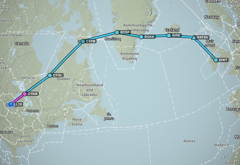

After a year's delay due to work/life commitments, my planned RV-10 trip to Ireland is back on. Planned departure from home base (LL10) is Sat Aug 24th.

I leave tomorrow for Canada on the way to Ireland. Original plan was to overnight at La Grande Riviere CYGL, but the only hotel there says they're full. Plan B is Amos, CYEY. I'll still plan stop at CYGL for fuel on route to CYFB on Sunday.

Landed in Iqaluit
The -10 is an unbelievable machine. Completed the leg from CYEY to CYFB, 967nm in 5 1/2 hrs on 58 gal of fuel. Good weather almost all the way and a visual to rwy 16 to round it out. A good day...

Made it to Kangerlussuaq BGSF yesterday. Stopped for the night as the weather didn?t look good for the remainder of the leg to Reykjavik. Glad I stopped here, the scenery is spectacular and the people very friendly. Will try for Reykjavik today instead.

So glad I stopped for the night in Kangerlussuaq. I stayed the night at the house of a local tour pilot. Had a musk ox burger for dinner and great company as well. Today?s flight was perfect. Kanger tower cleared me to fly east up the valley before joining filed route to BIRK. Simply spectacular. Climbed up to FL150 over the icecap, relayed a few calls for a travelair going the other way and was treated to yet more spectacle on the east coast of Greenland. I just can?t imagine a more hostile environment than down there among the cliffs and icebergs. Not to harsh for some though, a tiny iceberg started to move quick and left a wake :). OAT was -17C over the North Atlantic with a solid layer below. Finished up with a nice ILS to rwy 19, breaking out at 900ft. I hope I live to tell my grandkids about this.

Paddy/Jim has landed at the Weston airport outside of Dublin.

Well, after a year of planning, N415JS finally arrived in Dublin. This was a very emotional experience for me. My Dad worked for Aer Lingus as an engineer in the flight simulator department at Dublin airport, so by the time I was a teenager, I had a fair amount of unlogged sim time in the 707 and 737. I just took it for granted that I?d be an airline pilot when I grew up. When the time came, I aced the aptitude tests and failed the medical for less than 20/20 vision. Correction wasn?t allowed in those days. I moved to America when I was 25 and learned to fly about 10 years later. I passed my checkride a month after my Dad passed away. Fast forward to yesterday morning and I can?t believe I?m talking to Dublin approach and being cleared for an instrument approach over the City I grew up in. And this after flying over the Atlantic. In a plane I built myself. This one?s for you, Dad.
