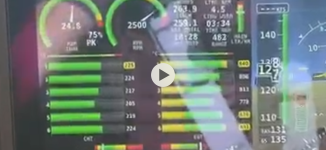

Been a little toasty in the UK recently with temps around 80 F. With full throttle on take off the No1 cylinder indicates the hottest but 1,2,4 reach 1550F the rest just under 1500, pretty much stays that way even when RPM reduced to 2500 until airflow increases to around 125kts indicated. The No1 CHT also peaked momentarily at about 420F albeit for a few seconds, which I have never seen before. Fuel flow on take off is around 88 l or 23 ish gallons an hour, so it’s getting enough fuel on take off according to Vics video on base leg.(Edited to say having rewatched it’s not)
Cruise is all fine but I have noticed I cannot move the mixture very far without EGT’s going into the high 1500’s again, so leaning is almost a non starter, it used to lean absolutely fine with a fair amount of movement to see any spikes.
I appreciate CHT is the important one and the no1 is normally the hottest but surely I shouldn’t be seeing these high temps on take off with temp outside in the 80’s F. Is it a case of checking fuel nozzles, baffling around the engine or a hazard of a 540 on a hot day, I never noticed any of this with external temps in the low 70’s. Or poor control of RPM etc after take off? I do not use the Dynon leaning setups.
Sorry rubbish picture but 225C is 437F, 840 is 1562, the peaks.

You are running WAY too lean at WOT. I have to question the accuracy of your FF instrument. 23 should be plenty, but no way that 23 GPH nets EGTs in the 1500-1550 range
You are running way too lean. I have to question the accuracy of your FF instrument. 23 should be plenty, but no way that 23 GPH nets EGTs in the 1500-1550 range
If this just popped up out of the blue, my first guess is a fuel leak downstream from the red cube. Youare reporting 23 gph, but 1/3 of it is going somewhere else other than the cylinders. given the even distribution, i would suggest the leak is between the red cube and the servo. it is not related to a 10* increase in ambient temps.
Is this FF reading with the electric fuel pump on? In many cases, with fuel pumps positioned prior to the FF sensor, erroneously high FF readings can occur. Does the FF show the same with the fuel pump off?
As Larry suggested, somehow the engine is short on fuel in your condition. Have you seen any dye remnants from the fuel anywhere along the fuel routings in the engine compartment?

Ok thanks chaps, suspected as such , fuel flow with the pump off drops from 25 to 13 ish gph , it’s definitely not getting the fuel , I’ve seen no leaks other than a recent small drip from one of the drains under the wing , will give the Engineer a call and get the cowlings off. Also I’ll get some data downloaded.

while that could mean you have an issue with the mech pump, it doesn't necessarily explain the symptoms you stated. you were indicating 23 during the phase when the egts were 1500, correct? assuming the boost pump was on; is that correct? in that case, a failing mech pump should have no bearing as the boost pump is doing the work. flow is flow unless there is a reason to suspect an inaccurate flow reading or the fuel is flowing somewhere other than the cylinders.
am i missing something here? were you getting the 1500 while showing a 23 flow rate?
840 C =1,544 °F. But don’t get distracted from the real issue. I’d suggest the ‘coke bottle test’ (flow fuel from the injectors into 6 bottles.)

NO, it is not getting enough fuel on take-off at all (WOT/2700/ Full Rich). I will bet this is an AVSTAR FCU, every single one I have come into contact with does not flow enough, and some have been below minimum spec. as tested by an accredited shop with the correct test gear and fluid. If you have 88LPH this is your immediate problem so get that FCU off and ask for the output to be increased from whatever it is now (X PPH) to (X*1.09 PPH). That 9.1% increase is damned typical. I have a RV8 customer burning 60 instead of 66, again 9-10% as have all the others been.
Assuming you are at sea level and roughly is near enough you should see around 96 LPH and not less than 94.5LPH. Typical EGT would be in the range of 675-690dC depending on probe placement and timing.
Another point, check your mag timing. If magneto's must be 25DBTDC and no more. If an Electronic, must be in the 22-23 degrees range (because that is effectively what the mag would achieve).
Until you get it complying with the above you will continue to have problems.

Hi I was just answering the prev posters query on what the flow was with it off, once the pump is off the temps, particularly on cyl 1 stay high, certainly above 800, having rewatched Vics video I can see fuel flow on take off is just less than 23 and not 25 plus. I will be meeting with my Engineer to investigate, thanks for all the advice, will post back the findings 👍🏻

On my 10, I typically get around 23-24+ GPH at full TO power at 800' MSL. that is totally fine. Ignore the guys that say you must be 25 or over. If you read the Lyc charts in the operating manual, you will see that 23 is very near or above the min req flow, which is already a bit conservative. The servo adapts to density, so it will flow less fuel when the air is hot and more when it is cold. It won't be a constant number.
So, 23 is great, but your EGTs tell a different story. They say the engine is seeing far less than 23. so, need to find out why. If this just popped up, meaning you used to see EGTs much lower, it can't be just an FF indication error. It has to be in combination with something restricting flow or you have a leak, allowing the fuel to go somewhere else.
The reason I keep saying leak is it would be quite odd to have both something that reduces or restricts flow appear at the EXACT same time that the FF errors showing exactly what it is supposed to. Seems like too much coincidence. A strange set of symptoms for sure.

Should have mentioned this yesterday. Need to check your ignition also. Running on one plug will raise EGTS about 150* + compared to running on two. This will generally reduce CHTs a bit, not raise them. So, if those 437* CHTs are normal, this could be your issue. If the CHTs used to be substantially lower, then too little fuel is more likely.
Need to do the mag check at high power, like in flight, as sometimes the ign will only fail to spark at high power.
