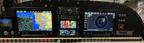

If you look at my CAD design, you will see that I was able to get a G5, two G3Xs, two GPSs, audio panel and AP head placed without interfering with any fo the ribs.

Your panel looks very nice. However, I would not want to have to shoot an approach with the G5 installed way down there. Hopefully that never happens to you.
Larry
I’m around 6’1”
It’s not so much the panel depth but a combination of depth and the width of the center console.
The whole thing was driven more by my desire to have the GDUs together and as far left as possible. Which led me to keeping the vans panel (modified with the zigzag)
I accept that the G5 on the center console is less than optimal but ultimately everything is a compromise and I don’t have any issue with it hangar flying.
A lot has to go wrong before that’s my last option.

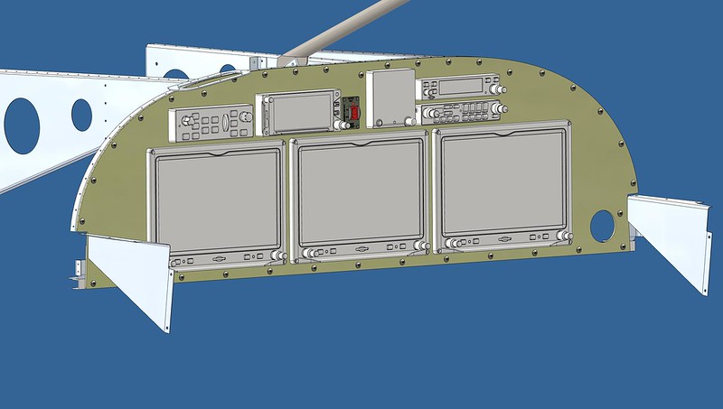

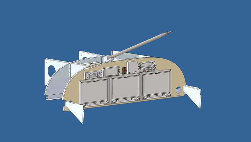

Just started modeling my panel in Autodesk Inventor. The problem is to find all other component STEP files.
I had to increase the height of the panel by just 0.5" and everything now perfectly fit.
You are welcome to copy more components from my CAD model, the components can be exported in all kind of formats. I have modeled a start button, round buttons, GD-40 CO monitor, SDS components, IBSS battery, VPX-Pro, warning lights, flap switch, ACK ELT, LC-50 lighting controller, potentiometers, micro-LED strip, Globus AC controller, ignition key, forest of tabs and circuit breakers. See https://cad.onshape.com/documents/5...renderMode=0&uiState=638a2fe71e3aea28e8ef118e

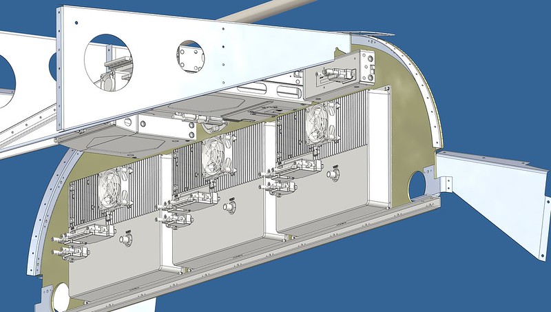

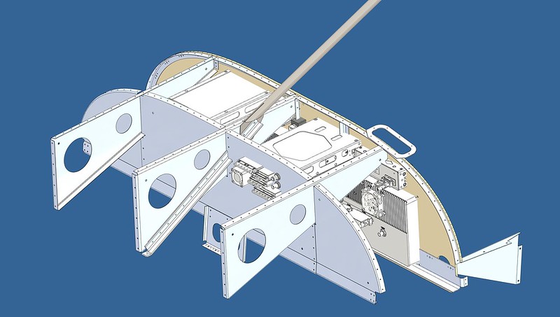

Concerning your design, you need to check the mechanical stability.
The G3Xs take out most of the panel itself, only a very floppy skeleton will be left and you have taken out pretty much all of the switch bar which gives the lower part of the panel stability.
The switch bar along with the left and right radio stack angle brackets also usually creates a rigid grid structure between the top and lower panel edge.
I haven't started a skeleton itself, but I will add a lower panel which will be a kind of support for the primary instrument panel. Like Richard did, And I will use it just for switches and circuit brakers.
