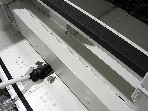

Geez, they are not that bad. Purely cosmetic. If you don't like the way they look, you could always cover them up like this. I use this as a toolbox and keep my tie down kit and spare parts hidden underneath a hinged door.
Pretty cool! That looks really nice.

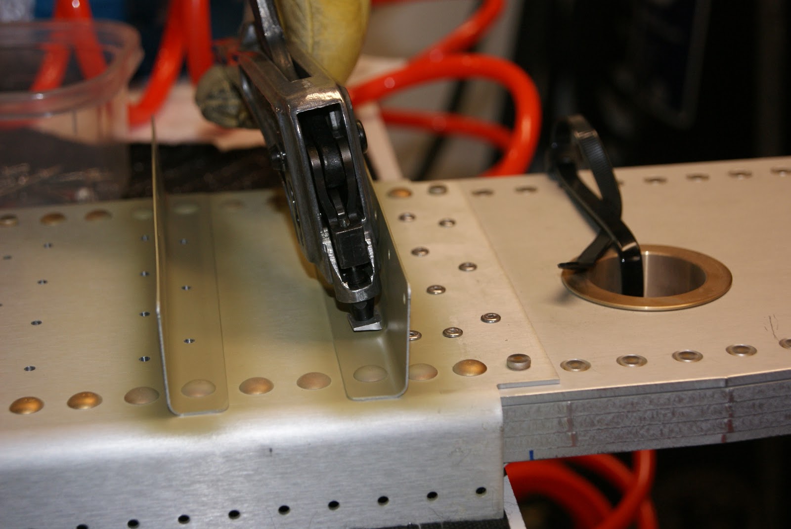

Below are a couple of photos of my spars received around the late 2012 time frame for you to compare. The first photo shows clearly how unfinished the edges of the spars are ... actually this area was not that bad. Some places on the portion of the spars that slide into the fuselage were quite rough and sharp enough to tear skin. Ignore the countersinks, you will not see those on your spars.

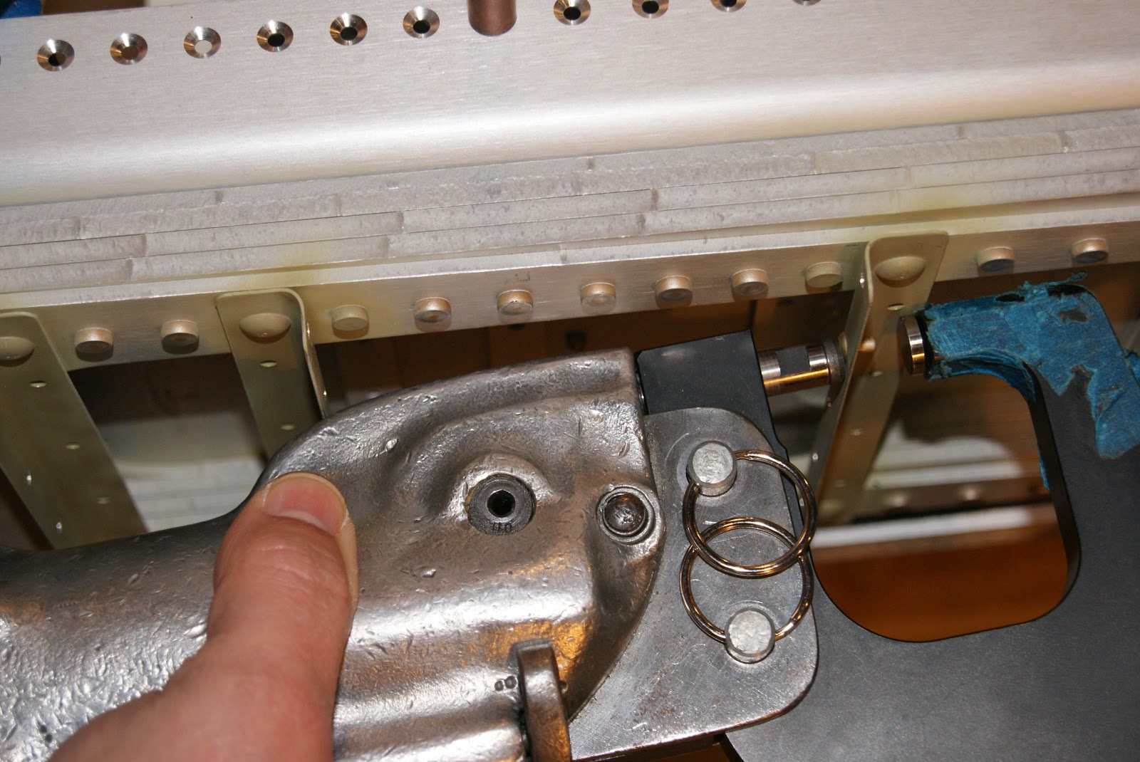

The second photo shows where I did a little light filing to knock off the really sharp edges where the spar will be handled. No attempt was made to make all the metal smooth because did not want to get into the anodization.
