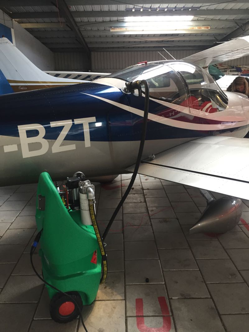

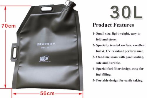

At the airport we only have 100LL(?2,66/l ~ $11,22/USG) and UL91 (?2,55/l ~ $10,75/USG). At the car fuel station we have E10 and E5 (Ethanol free ?1,84/l ~ $7,76/USG). So to avoid 100LL and high fuel prices I use E5. To refuel in the hangar I use an Emilcaddy 55L (~15USG) with electric pump + filter. For enroute and when no mogas available I have a foldable jerrycan otherwise 100LL + Decalin.

When a MOGAS airport doesn't fit our trip or route, we carry bags as shown in the post before available from https://www.airframesalaska.com/Liquid-Containment-Bag-p/5.2bag.htm. We look for an airport near a interstate highway interchange and use their courtesy car to get MOGAS. We're sure to leave a nice tip for the use of the car.
