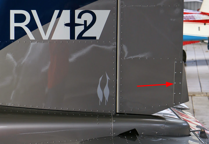

Instructions were included. Rivets I can't remember. I looked up my order and I noticed that I ordered extra AD-41-ABS. The front row of rivets are the "normal" rivets. The aft row are the AD-41-ABS rivets.
I ended up with a little gap at the front of the trim tab (red arrow). If I could do it over I would break the forward edge of the trim tab.
Just look at the picture above for orientation. Note that the lower edge of the tab aligns with the lower edge of the rudder. The shorter AD-41-ABS are not included with the Trim Tab. Be careful when you install these shorter rivets - if you push too hard when installing these rivets you may create a slight dimple on the opposite side of the thin rudder skin. Push/squeeze them in phases similar to the way its done for the aft flaperon rivets.

Hey Tony!! I received my trim tab today, but I didn't get instructions, or rivets, like some of the posts mentioned. So, I ordered the special little short guys today. It looks like you just drilled out the bottom rear rivet in the rudder skin, used it as alignment, clecoing the trim tab in place, then squared up the trim tab and drilled the rest of the holes with the trim tab in place. Does that sound about right?

That sounds about right. I took the rudder off so I could work carefully with it flat on the bench, did not want to mar my paint. Also, with the rudder off, I was able to get the remains of that drilled out rivet out thru one of the openings.
