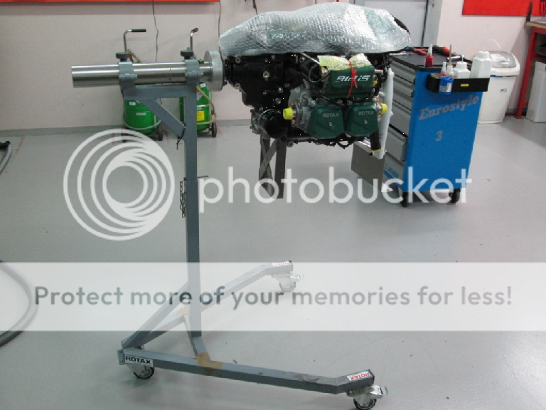

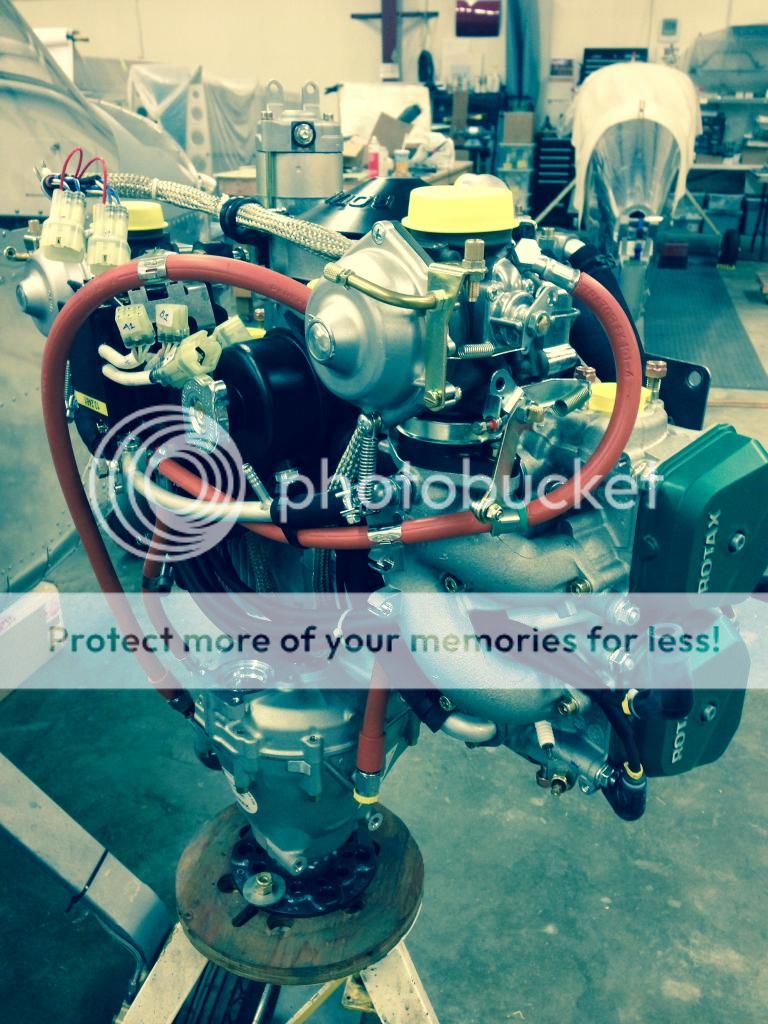

Can someone advice if thats "ok" or not to keep the new engine for few days on a stand like in the picture please.
I don't think in 15 years I have ever seen or heard of this being done.
Personally I don't think that is the best solution. The engine has more than enough mass to tweak that prop flange and I'm not sure what it may do to the shaft oil seal. I see you still have the metal crate plates on the bottom. Why not just set it on those or two blocks of parallel wood?
The prop shaft and new bearings and seals will cost about $750 just for the parts not including labor. There is some oil still left in the engine, not much, but no sure where it's going to go.
I would like to post this picture on the Rotax website and get some comments if you don't have any objections?
found another thread below, 07 built and guy said stand like in this pic is in the rotax manual.

Here is the comment from Rotax.
"Both are bad news for the engine. Let is remember that this is not a
direct drive, the weight and all the forces are not in direct line with
the crankshaft, it is offset to because of the gearbox.
This type of mounting is common on direct drive engines and should be
avoided on geared engines for this reason.
The worst is the one were the
engine is flat and all the mechanical leverage on the prop flange could
perhaps cause a real problem with the bending or fractures of the inner
bearing retaining bolts."
Bottom line don't do it and don't treat a Rotax like a Cont. or Lycoming. Number one mistake by A&P's working on a Rotax. Fixing A&P work on a Rotax is approximately 30% of my business because they either treat them like a Cont. or Lycoming or have no idea about LSA regs.

Still does not pass the smell check for me. The engine weighs less than 140 lbs dry. At take off power the prop flange, PSRU and engine case are subjected to more than this amount of force.
Why risk it. Sure, the engineer in me says more load is placed on it when mounted on a plane and in operation. But, I designed highways and airports, not engines.

Pipistrel is a large international aircraft company that manufactures several aircraft models that use the Rotax 912 series engine. They advertise 15 years experience consulting, maintaining, repair and overhauling of Rotax engines with trained mechanics.
On some models they make modifications to the engine and they do it at their factory using engine stands that bolt to the Rotax 912 prop flange and hold the engine in a horizontal position, see picture and text below.
"At Pipistrel we fix the engine to a stand, similar to the one in the photo below, this makes modifying and moving the engine around the workshop much easier. In a nutshell, this manual covers the following procedures: modifying the water pump, adding the oil thermostat, mounting the cooling plenum, mounting the exhaust system and mounting the oil coolers."

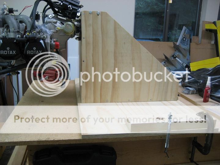

Additionally, Pipistrel home builders have constructed similar stands out of plywood that suspend the engine horizontally by the prop flange. One such picture was posted earlier in this thread.

Think of it this way. Hold 5 gals. of water up off the floor , but with your arm hanging straight down. No problem. The arm was designed to support heavier weight that way. Now hold that same 5 gals out at arms length. Don't let the elbow or wrist bend or the shoulder sag. Same water weight, but different use of the appendage which really wasn't designed to hold heavier weights like that. If you tear the rotator cuff (the prop flange) then you'll know that the flange on the plane has more weight suspended outward that it wasn't designed to carry in that type of side load.
Pipistrel has been having a few of their own issues lately with the 912is. I have been called by several owners.
If Rotax saw them suspend and engine like that they would just shake their head.
Remember this has a gearbox and is offset and then you dangle 125+ lbs out there by the flange as it puts all that side load in one spot on the oil seal and bearing. By the way the bearing is not all metal. Next time someone pulls a gearbox apart take a minute and look at the bearing down inside.There is plastic there for them to break and crack. This type of engine mount is an old hold over from the Cont. & Lycoming days. This isn't the same engine and people are supposed to be up on their game a little better.
Just because you get away with something doesn't make it right and you won't get tagged.
