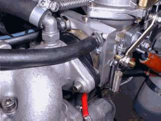

Another solution is to use coolant to heat the carb bodies - there are commercial kits to do just that (photo below). Ice is a problem in the UK where is always cold and wet except for high summer (no offense to my Brit friends, God Save the Queen) and this solution seems to work very well there.

My 912ULS came with factory installed with Carb Heat. Coolant circulates continuously thur rings mounted between carb and manifold. I have chosen not to use it as it robs HP at cruise. If I lived in the UK I would definitely consider the factory Carb Heat System.

On my 12, I'm going to fit the Sky Drive (ConAir) coolant fed carb heating sytem. The theory is you don't lose performance as you are heating the carbs not the induction air.
