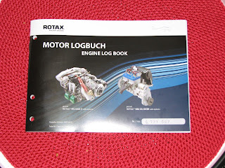

It is a while since this thread was alive but I just ran into the realization that my engine is also within the range of serial numbers affected by this SB.
I was about to just order a replacement fuel hose when I came across this article from Scott talking about checking the engine log to see if this has already been done by Van's.
Well, WHAT ENGINE LOG? My engine did not get shipped with any paperwork that would qualify as an engine log, so I'm pretty confused right now. Even more so as Rob seems to have been able to check compliance in this mysterious log.
Any hints as to what I might have overlooked or been missing?!
Torsten, the engine log that came with my Rotax documentation is a softcover booklet, if that helps.
It looks like a pamphlet. You may have thought it was just ROTAX propaganda, but it is an engine log. Easy to misidentifying if you don't flip through it.
Every engine comes from Rotax with a logbook. Mine, for my CT is clearly labeled "Rotax Motor Logbuch" and "Engine Log Book". It is specific to that engine.
Measures 5.8" x 8.3", greyish in color with a red white and blue striped border.
If yours didn't have one with it, call Van's.
I'll browse through my stack of documentation when I get home and see if I can dig it up.... I don't recall seeing anything like you described but one never knows.
Thanks guys! Your hints were all helpful and I found it stashed away with the service and maintenance manuals as it looks just like them. I had never opened it or realized what it was before tonight. I'm happy to see that the SB had already been taken care of before delivery of the engine. One less thing to work on!
