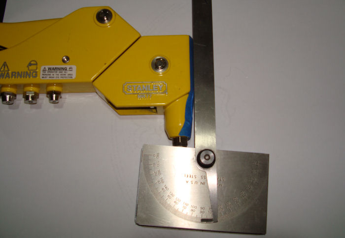

This is the way I am pulling those rivets in tight places
Grind the removable nose to a 5 degree angle then radius the sharp edge to stop the tool from marking the work.
Grind off at an angle the front of the tool and add blue painters tape to prevent marking the painted parts.
I tried the wedges and the Avery tool and that is the reason I did this.
This tool works
