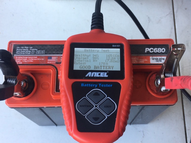

UPDATE:
I tested the battery, it tested very good, (with this tester) for a 5 year battery. Next step is to compare the Dynon voltage with a different volt meter. The 12.2 (Dynon) voltage reading is what started this concern.
Autozone Auto Parts stores will test a battery under heavy load. This is a measure of internal resisitance and the battery's ability to deliver rated amperage.

Today I tested the battery after sitting with no load for 48 hours.
Measured at the battery the voltage was 12.84.
I powered the Dynon only and the reading at battery dropped to 12.1. At the same time the Dynon showed the battery at 12.0.
Next I turned on the landing light, nav lights, autopilot, and radio. The voltage at the battery was now 11.78 and the Dynon showed 11.6. The current used with everything on was 19 amps.
Note; the difference in voltage readings between the Dynon and my meter is roughly .1 volts, 10%, probably just variations in the calibrations.
My conclusion is the battery probably has a bad cell that can?t supply full voltage with a moderate load. I don?t expect it will suddenly fail but needs to be replaced in the near future.
I hope this info helps someone else.
Pulling 19 amps on a 165 to 175 aH battery is a very heavy load. I would expect the voltage to drop below 12.0.
With a brand new battery, showing 12.85 V at start, the Dynon SkyView Touch usually shows 12.2 to 12.3v in the yellow, right before starting. Depends on if the fuse for fuel pump is installed, or not. We generally start the motor without the electric fuel pump, let the Dynon boot up, get up to 2500 rpm to excite the fields of the alternator to get positive amps and charging at 13.0V, then put the fuse for the fuel pump back in the fuse holder.
I don't think you've so much a dying cell as much as you need to let it sit on a 14.4v max recharger for 48 hrs to desulfate as much as possible the individual cells, before putting back into service. I say 14.4v max, due the the AGM chemistry in this battery.
You'll know when the battery is dying or dead... you'll try to start it and it won't, the starter solenoid will just click . Next thing you know, it's possible you'll blow the 5 amp fuse on the electric fuel pump. Don't ask me how I know this, done this 3x in the past 15 months. 2x with new batteries from Aircraft Spruce under warranty. First one lasted 6 months, the second one 3.5. Did a complete electric current draw trouble shoot and came up blank.
