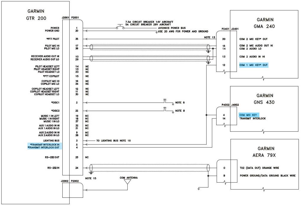

Carl,
We are curious if your installation included a connection from the GTN 650 MIC KEY to the transmit interlock input on the GTR 200 radio, similar to the drawing below (with a GTN 650 in place of the GNS 430). If that connection is made, any time the GTN 650 mic key is pressed, the GTR 200 receiver should be de-sensed to prevent this from happening.

Carl,
Justin
Justin - I don’t know as this was not my RV - but I did have several cross country hours in it. I do know the panel was done by an authorized Garmin shop.
That said, it seems to me that this “de-sense” fix would prevent the capability of pilot and co-pilot communicating on both radios, different frequencies, at the same time (split mode). Perhaps this limitation is listed in the GTR-200 manual - I don’t know.
