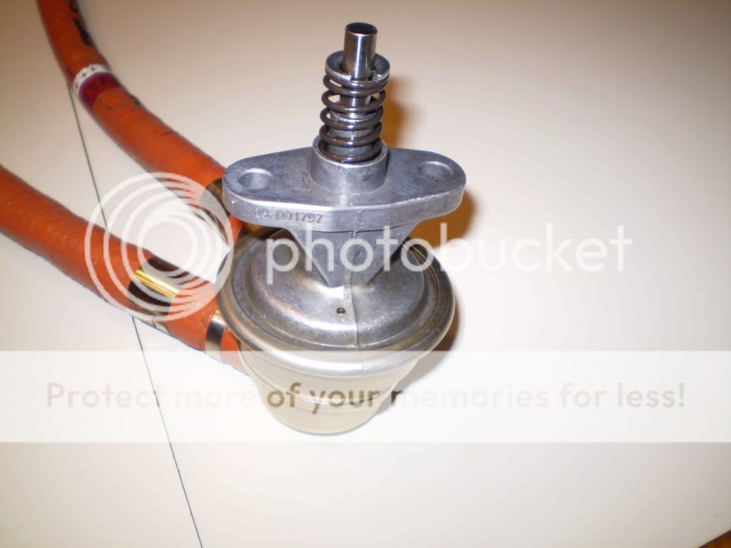

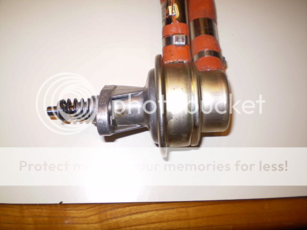

I recently had a fuel pressure problem to. On takeoff roll after reaching full power the engine started to lose power and run ruff. When power was reduced all readings returned to normal. On the ground during a full power run-up I received at first, a fuel flow alarm showing fuel flow exceeding Max red line then Second, the fuel pressure reduced to the yellow arc. Again when power was reduced all readings went back to normal. After inspection of the engine driven fuel pump we noticed a very small amount of fuel (less than a drop)leaking out of the weep holes on the back of the pump. Per the new video on Rotax-Owner.com web site this indicated that the pump was bad. A new Pump was ordered and installed. All engine ops returned to normal. Twelve hours and still no problems. Here is a picture of the fuel pump.

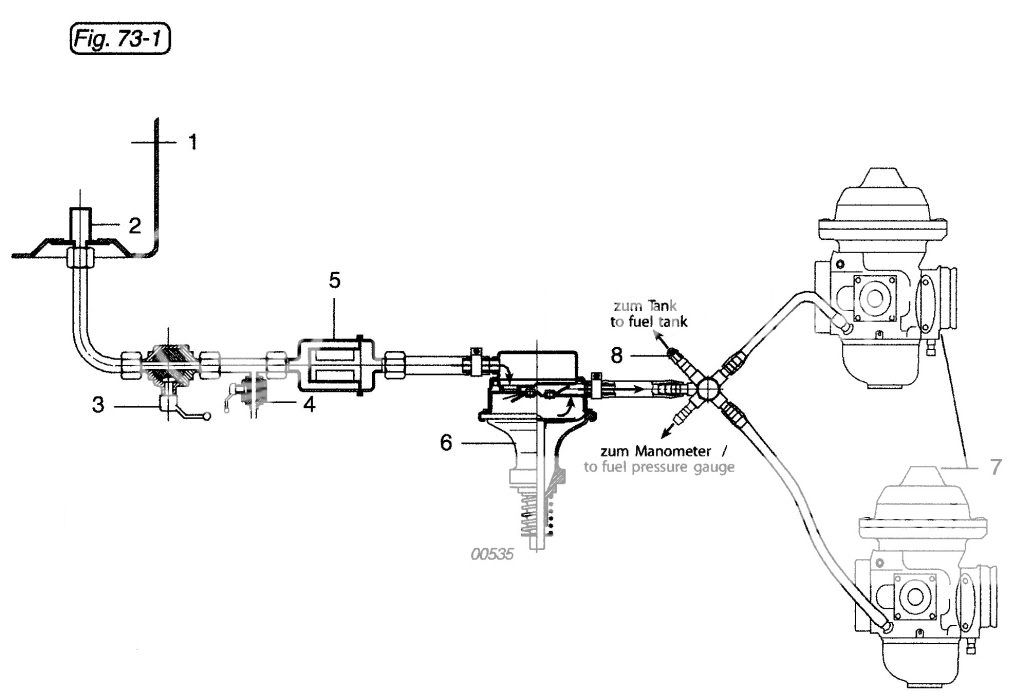

I run premium unleaded, no ethanol, 110 hrs on engine. You can see a small brown fuel stain on the weep hole. Premium unleaded turns brown when it dries. Here is a picture of a typical fuel system and fuel pump schematic from a Rotax maintenance manual.
As you can see the Rotax fuel pump is not a impeller type fuel pump but Diaphragm pump. Any crack or leak in the diaphragm or case will cause the pump to go bad. There are two pumps you can buy, Part #892-546 comes with the fuel line attached $511 and part #892-542 one with no fuel lines attached $168. After the warranty runs out I will be switching over to the cheaper one if I need a new one. LEAF says they sell 3 to 4 pumps a month. Not a good sign of how dependable these pumps are. I don’t think the engine would stop running in flight if your pump starts to fail but you probably will not get full power. As in this thread and others on the form about this subject engines continued to run. I am also not sure why the fuel flow would increase to the red line as fuel pressure reduces. I believe that for some reason as air is induced into the system through the pump flow increases back to the tank via the return fuel line. Maybe someone with more experience with diaphragm pumps could explain this phenomenon which is why I included the fuel diagram. Some people who do not run Rotax engines seem to diagnose this high fuel flow fuel indication as fuel Vapor lock. The new fuel pump fixed my problem so that wasn’t’ the case. I also think that the Rotax fuel pump could be bad and not indicate a fuel leak. It’s an insidious problem because even at a 4000RPM runup before takeoff the engine ran fine, only at Max power did I begin to have problems. Several times back at the hanger we did max power runups after the aborted takeoff and the problem didn’t occur. Maybe on the takeoff roll as airspeed increased and RPM slowly increased as a result and the demand for fuel increased in the carb jets the pump couldn’t keep up with demand as it started to induce air into the system through a possible crack in the diaphragm. The builder in me would have loved to cut open the fuel pump to inspect the inside to see why it leaked(it’s a sealed unit). But because it was a warranty item I had to send it back intact. I really like the Rotax engine but some of the accessories seem to be weak. It’s hard to know the exact data on failures of these types. As with the Honeywell oil sensor failures sometimes the things last for hundreds of hours and then sometimes they fail right away. Hey Larry G in your past have you had any problems with the fuel pump? It would be great if all three Rotax dealers in the USA would request a Rotax Tech Rep from Austria to attend OSH and give a talk about these Accessories and any improvements that maybe down the line. It was quite a coincidence cause recently a new Video on Rotax-Own.com came out about this very problem so maybe Rotax knows about this problem. I would think that the USA is one of the largest users of the Rotax engine. It would seem that the dealers walk a fine line with Rotax in their marketing agreements as far as feedback they can give them on these problems. The remote mounting fire wall kit that Lockwood sells for the Honeywell oil pressure sending unit would be an example of this dilemma. Lockwood knows that having the pressure unit out on the front of the engine causes it to fail vs having it mounted on the firewall, but they are unable to get Rotax to change it. Anybody who has owned a BMW would understand how precise the standards are with the Germans and how hard it is for them to change things. Well I guess it not a perfect world anyways. Still love this little bird and am having a great time flying it. See you at OSH.
