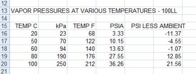

Bring on the sunshine. Ever look at a vapor pressure chart for 100LL? Pressure applied to the inside of a blister rises very rapidly as surface temperature goes up. Once the stressed paint starts separating, a few trips into the hot sun has vapor expanding out of the sealant, blowing the bubble.
